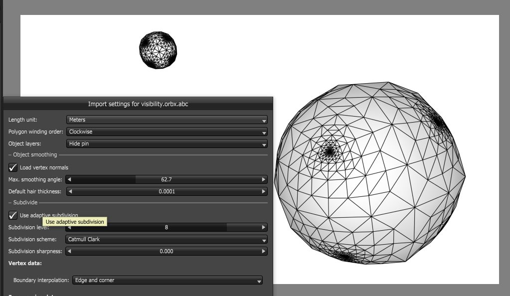

abstrax wrote: [*] Added support for adaptive subdivision surface.
Hi Abstrax,
Where is this "adaptive subdivision surface method" coming from ? and what is it supposed to be useful for ?
As in my test, I can see this have nothing to do with the "Opensudiv catmull-clark adaptative" method, or even a view dependent method...
Is it supposed to be a "surface normal" dependent method ?
2 cubes at different depth and using adaptative subdiv level 8.

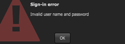

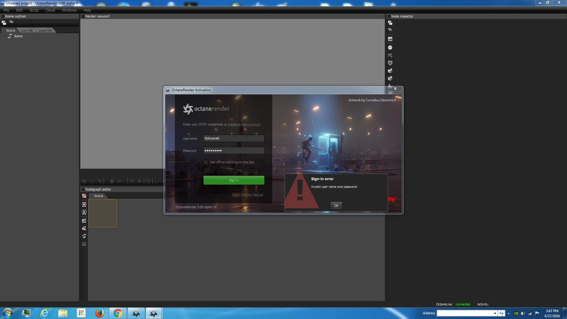

I get "Sign-in-Error", Invalid user name and password. Just copy-pasting from the Licenses page.
Also tried my forums login info on the 3.10 info entry, didn't work either. :?
Where do you get your Otoy login info, is that same as forums login?
3.9 Alpha loads in fine.
Thanks!

me too..invalid username.

Notiusweb wrote:I get "Sign-in-Error", Invalid user name and password
Don't use the license username and password but the same username and password used here on this forum when you signin to access your Otoy Account profil.
