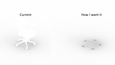

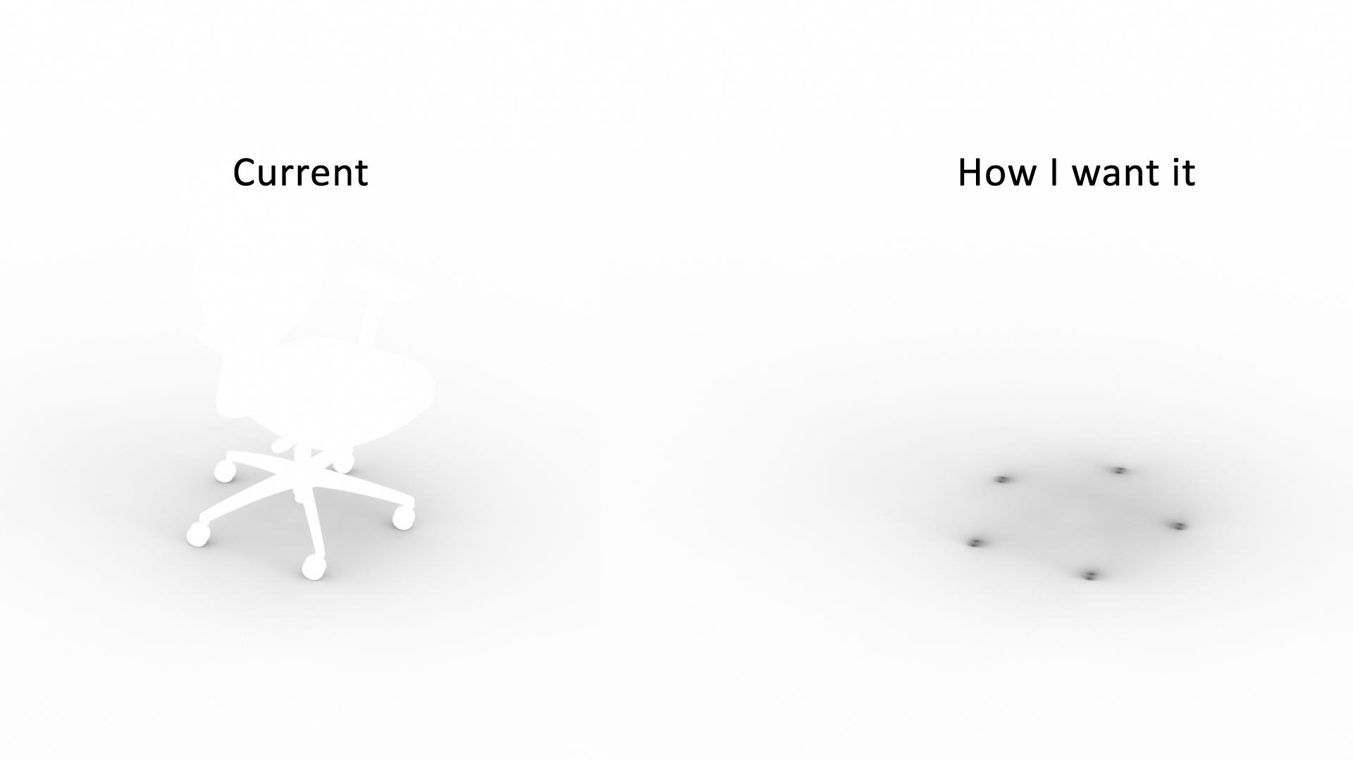

6. For shadow passes, it currently cuts out the object. This can create some problems when compositing because it has a small gap between the object and the shadow (this is more noticeable on lower res images). I attached an image that shows my work around. I separate the object and the floor into 2 objs and turn the camera visibility off on the chair. This way, when I place the object on top of my shadow pass in Photoshop, it works perfectly. This works but it creates more setup and you need to render twice (the chair is no longer visible on the beauty pass). I understand that the current way is how you would want it in some (maybe most) instances, but is it possible to add a checkbox to create it like my attached image?

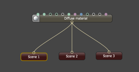

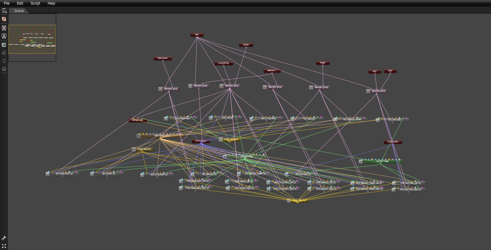

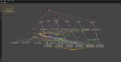

7. Cleaner nodes. It would be great if there was a connection node.
Essentially, If I have 40 render targets with different objs and all of them have the same material, I want to be able to change the material once and have it change it for everything. Currently the way to do it has a connection line from one macro to everything and it gets messy (and sometimes hard to select things because lines are covering it). It would be great if there was something similar to the input/output nodes for macros that allowed you to plug an input in and assign an ID to it, then plug your material into a node with a corresponding ID and have them connected without at line to each. This would make my scenes SOO much cleaner (especially when I connect kernels, cameras etc to several nodes so I can change them all at once). I attached an image of a scene that isnt that bad, but could really benifit from this feature.

check out my idea regarding the wire mess
viewtopic.php?f=9&t=53572
in sort, a way to hide all of the wires via hotkey as well as isolating wires for selected macros

About (6) above - this is something I have been looking for too, at least through the render layer node. It has taken some work to implement correctly and it is really a V3 feature at this point. You further have V3 deep pixel EXR's as one way to solve this problem in Nuke and other DP EXR tools without splitting the render into layers. It might be worth it to improve the OctaneImager system to allow deep pixel EXR layers, but that is TBD.

Having octane imager able to Handel better shadow passes sounds good to me, but we don't use nuke, so if that is the only solution, it's back to my work around for now.

No, that's not possible, because when a path hits an object on the active render layer, Octane has to decide to either shoot through it or to bounce off of it. When it shoots through it, you can see the shadows behind the object, but the object itself becomes invisible, which is not what you want, because obviously, you want the objects on the active pass to be visible. The path bounces off the object, we can't calculate the shadows behind the object. This is related to viewtopic.php?p=269484#p269484, which we will look into it as part of v3.

The problem with that approach is that it will be very hard to figure out what is connected with what after you haven't touched the scene for a while, because these connections are implicit and invisible. What you could do instead is grouping each scene with its objects and render target into a nested node graph (by selecting its nodes and then using "group items") and give each of them a linker node and then connect the material to those linkers:

Again, try using nested node graphs. This way you often can clean up things a lot.
