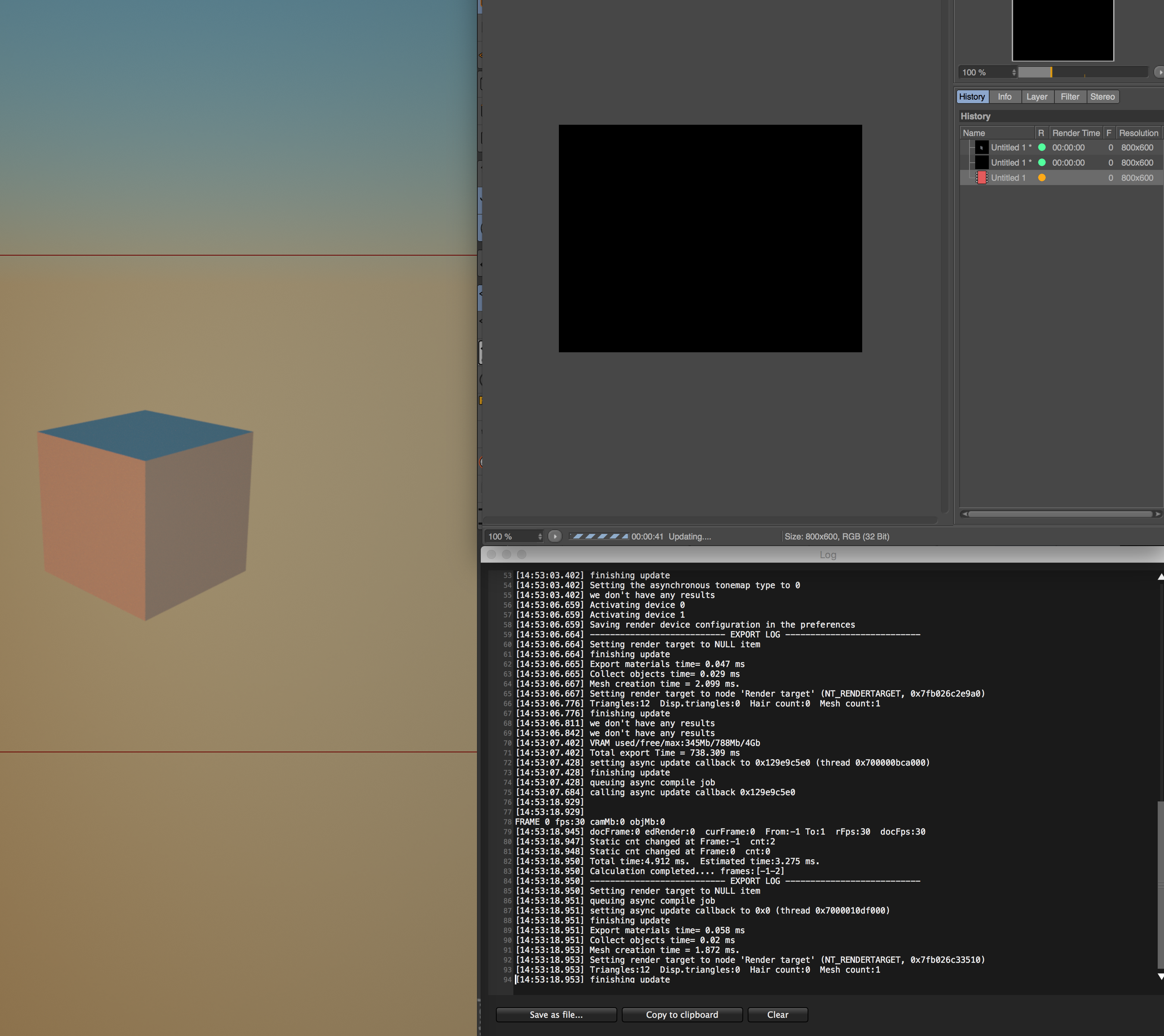

Hi Aoktar,
Please see attached Log file after reproducing the simple scene render using the same steps as before.
1. Render to picture viewer - Fails
2. Render to live viewer - Ok
3. Render to picture viewer - Now hangs on 'updating....' for some reason?
If I try and stop the render whilst is is hanging on 'updating...' C4D freezes and I have to force quit.
octane 3.00 alpha 6 160407 155429.log
(4.58 KiB) Downloaded 281 times
Mac OS X 10.11.4 - Cinema 4D R17 | Geforce GTX980 + 980ti | 32GB

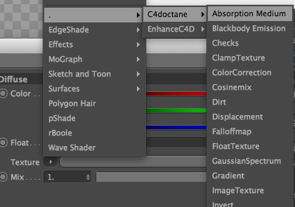

And secondly this version of the plugin seems to have been placed alongside my enhance3d plugins... it puts all the shaders nested under a folder simply titled "."
plugin shader problem
Both issues illustrated in the attached thumbs. Just wanted to flag them and make sure i wasn't doing something stupid to cause them.
