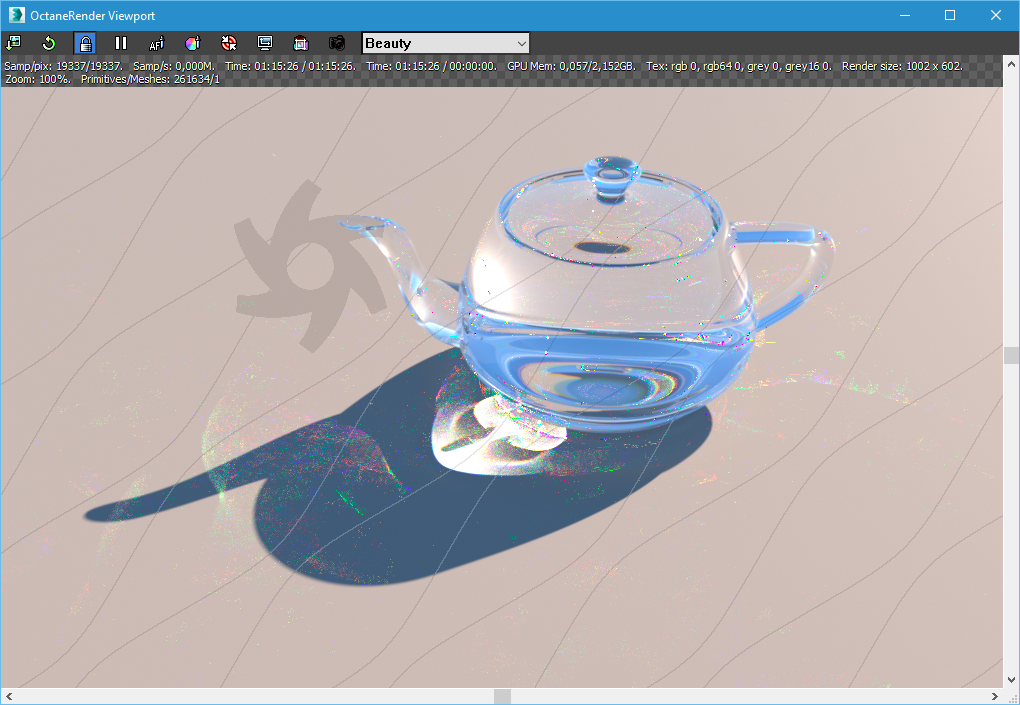

Render caustics are (almost) cleaned:
Sun sizes / resolutions screen - 1002x602 .... / 1920x1080 . / 3840x2160
0.1x (on Saturn)........................... - 13,500k spp* / 4,000k spp* / 1,000k spp*
1x (on Earth)................................ - 260k** .......... / 75.5k ........... / 18.9k
2x.................................................. - 78k ................ / 23k ............... / 5.75k
4x ................................................. - 23k ................ / 6.8k .............. / 1.7k
8x ................................................. - 7k .................. / 2.1k .............. / 525
10x ............................................... - 4.9k ............... / 1.45k ............ / 360
"spp" - samples per pixel
VERY IMPORTANT: do not forget to disable "caustic blur" from default at PMC settings. If we set to 10k-reject to may get some noises (noises colored if any specular material has dispersion) then we try more spp.

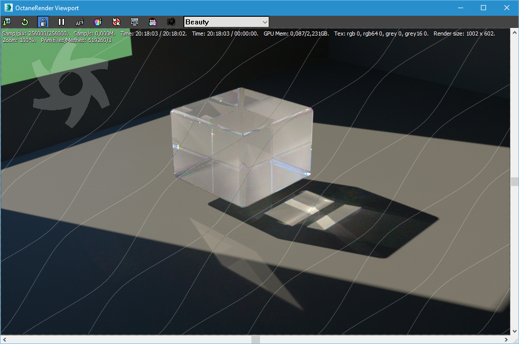

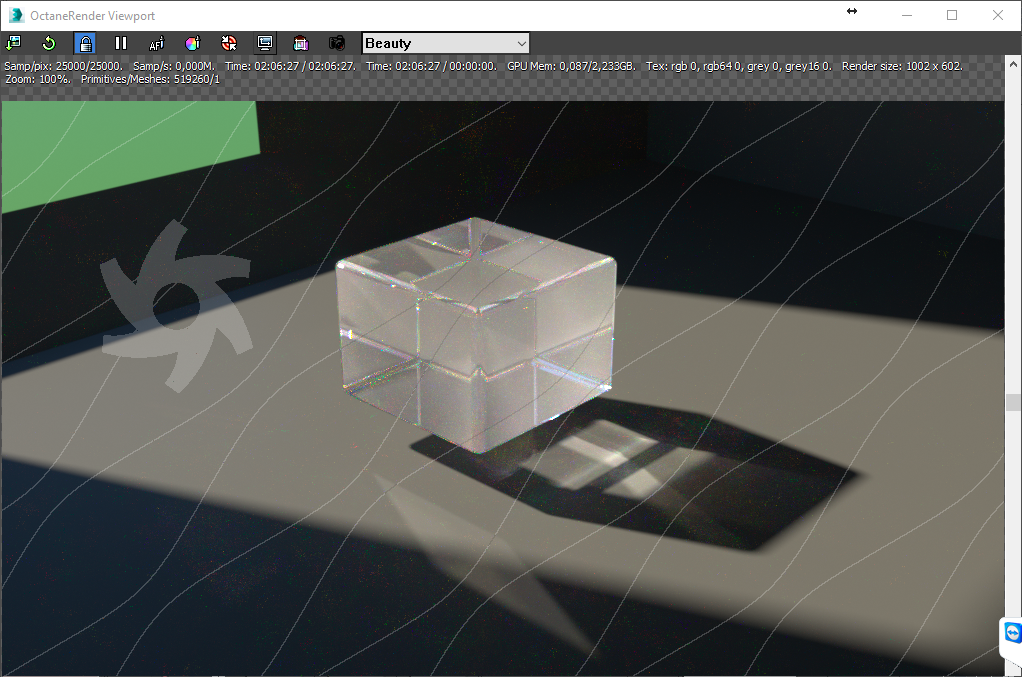

I investigated caustics... but I would need to increase from 23 kS/px to 50 kS/px at sun size 4x because this increase of S/px reduces noises colored for other things (not caustics). ;)
Sun size 4x at 25 kS/px
This image has to seem few noises colored. ;)
Sun size 1x at 256 kS/px
This image is cleaned and looks pretty well! :D
PMC settings:
27-depth both diff+spec
10k-reject
parallelism 1
"Ice" material:
reflection 0.930
transmission 1.000
ior 1.299
coefficient dispersion 0.003
--> Do you like that? :)

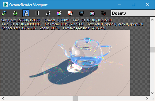

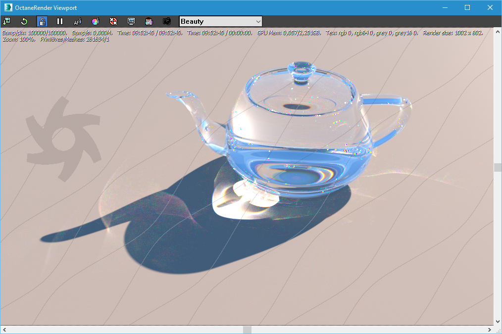

See differences of caustics between 3 images at S/px and resolution screen about teaport:
- at 360x216 - 150 kS/px
- at 1002x602 - ~19,337 S/px
360x216 and 1002x602 seem to be same caustics and same noises.
- at same resolution screen - 150 kS/px
Higher resolution screen = better caustics and less noises at 150 kS/px :) but longer render time. ;)
I'll buy OR in my anniversary (on july) but maybe few next months. :)
--> Do you like this? - but IMPORTANT!! Should respond me it. ;)
