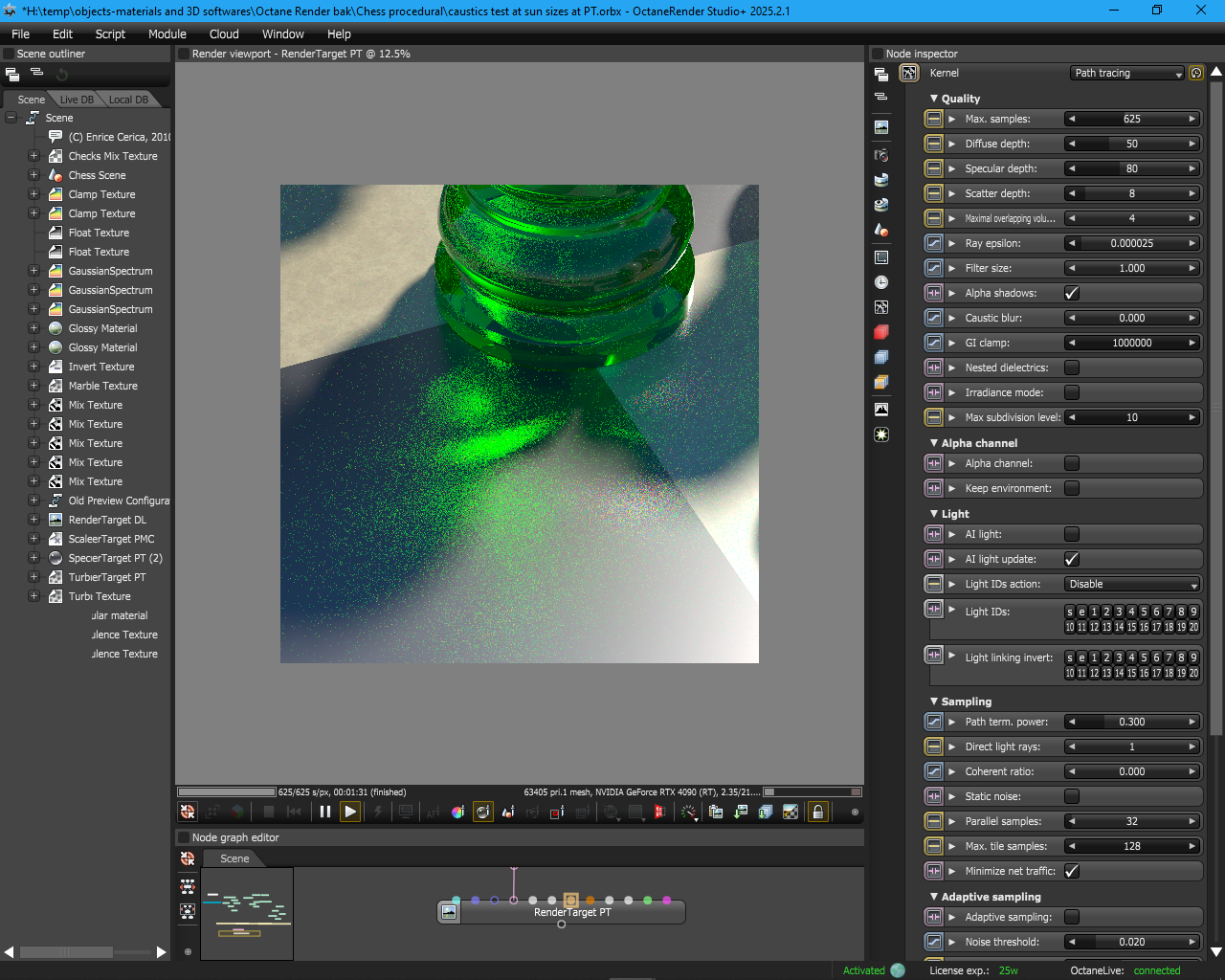

(( "Chess Procedural" scene :: these images below were rendered by my GeForce RTX 4090 GPU on OctaneRender 2025.2.1 Studio+ standalone ))

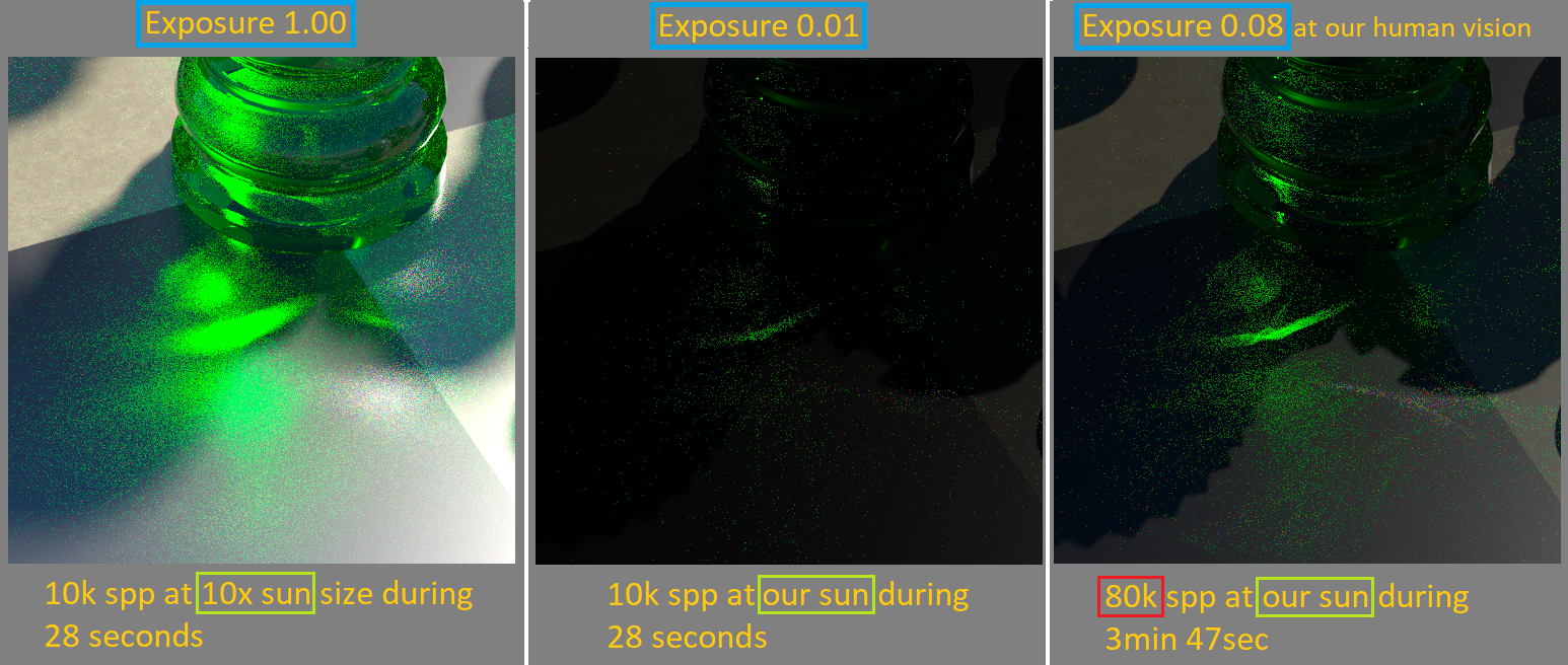

-- Between 2 spp's (samples per pixel) numbers are same noise levels at 2 sun sizes --
-- Between 2 exposure levels at 10k spp --
At square screen of 500 pixels@100% zoom:
-> -Formula- with normal exposure of 0.01 and human vision's exposure of 0.08:
exposure-human / exposure-normal x 10k-spp) = 80k-spp

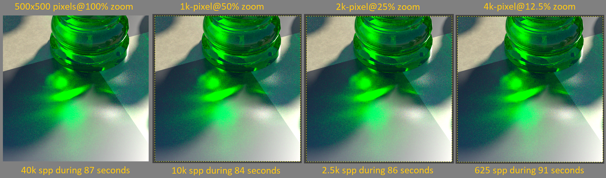

-- Between 4 resolution screens at same noise+color level of caustics --

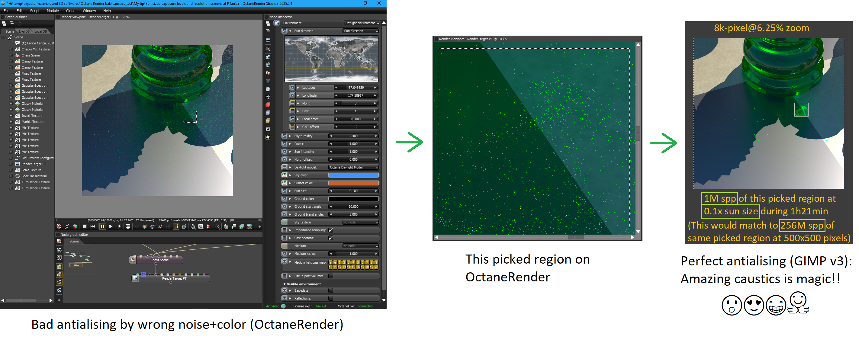

NOTE: Must use a GIMP program because OctaneRender gets bad antialising by wrong noise+color issue at less than 50% zoom:
12.5% zoom is an example.
Do NOT use PNG image for avoid any wrong noise+color!
Rest each 2x higher resolution screens and 4x lower spp can compete the original 500-px for same noise levels of caustics but unfortunately...:
-> on OctaneRender (OR) standalone
8k/UHD-2 may require 16GB RAM system for few light scenes or 32GB for (almost) all scenes as 16k/UHD-4 requires 64GB for standard scenes;
-> on OR plugin for 3D creator software (eg: Blender, C4D...)
8k/UHD-2 requires 32GB system as 16k/UHD-4 64GB for standard or 128GB for few heavy scenes.
--If you can't render any scene at UHD-2 or UHD-4 on 32GB RAM system at our sun or at dot light source without "caustic blur", try to re-pick region for 2 or more laps of 1M spp without any reset after completed maximum 1M spp:
Watch my tip - https://youtu.be/DHOP0b4-agc?si=-zhUJSRsaNA3oYu3

Open this project and click "Render Target PT" node to start rendering
