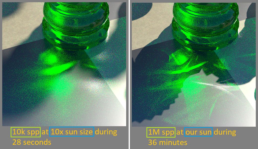

(( "Chess Procedural" scene :: these images below were rendered by my GeForce RTX 4090 GPU on OctaneRender 2025.2.1 Studio+ standalone ))
-- Between 2 spp's (samples per pixel) numbers are same noise levels at 2 sun sizes --
