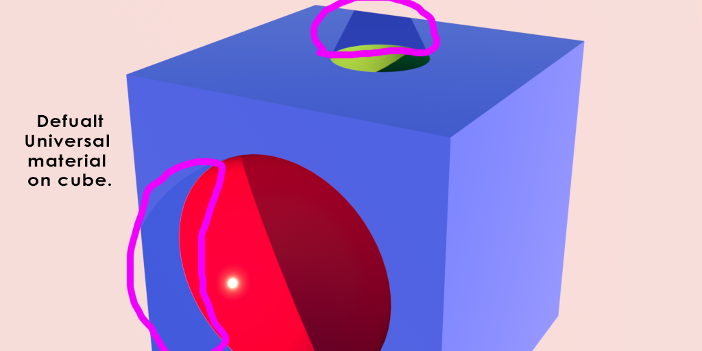

Clipping: Specular artifacts appear when using the Direct Light kernel.
When using Direct Light kernel there appears some issue where objects used for clipping show some kind of shadow outline of their original shape on the clipped object's material. Please refer to attached sample renders.
The cube has a default Universal material. The top side is clipped with a cone. The front side is clipped with a sphere. You can see part of those shapes reflected on the cube's material.
It doesn’t seem to be a shadow of those objects as they still appear even when the cube's object layer has shadow visibility toggled off.
Instead, this seems to be a specular artifact. Turning specularity to 0 removes these artifacts (but changes the look of the cube's material of course).
One way to remove these artifacts and still keep the cube's specular setting intact is by using a white transmission color and setting transmission type to Diffuse.
NOTE that these artifacts do not seem to appear when using the PMC or Path Tracing kernels.

Have you tried to increase diffuse/specular depth?pegot wrote:Clipping: Specular artifacts appear when using the Direct Light kernel.
