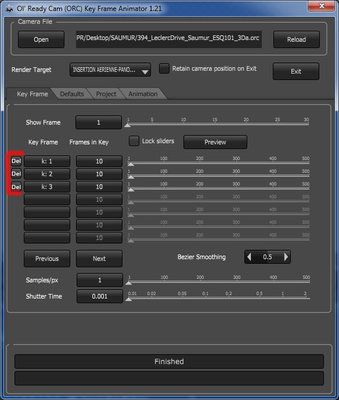

would be possible to:
- Add keyboard shortcuts.
- Add del key frame buttons
- To have scripting with the server (I or other letters
 or other letters
THANKS
 or other letters
 or other lettersTHANKS
How can I delete keyframes?

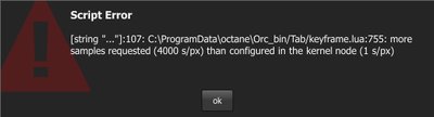

						Ok, was able to finally sit down and look at the code... and fixed (at least to my satisfaction) the issue I was having. Seems the render call was defaulting to 4000 samples/pixel but was being told to do just one/pixel...
so I added a couple lines to the code to set the sample/pixel variable.
Here render.lua:
and here keyframe.lua:
Here render.lua:
Code: Select all
 373       octane.render.start
 374       {
 375           renderTargetNode = self.targetNode,
 376           maxSamples       = samples,            -- added this line
 377           callback         = self.callback,
 378       }
Code: Select all
754    octane.render.start
755    {
756        renderTargetNode = Render.targetNode,
757        maxSamples       = keyframe.samples.slider.value,  -- added this line
758        callback         = Render.callback
759    }
