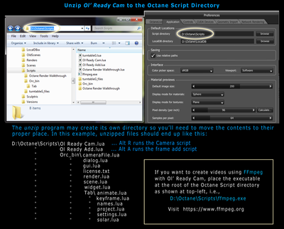

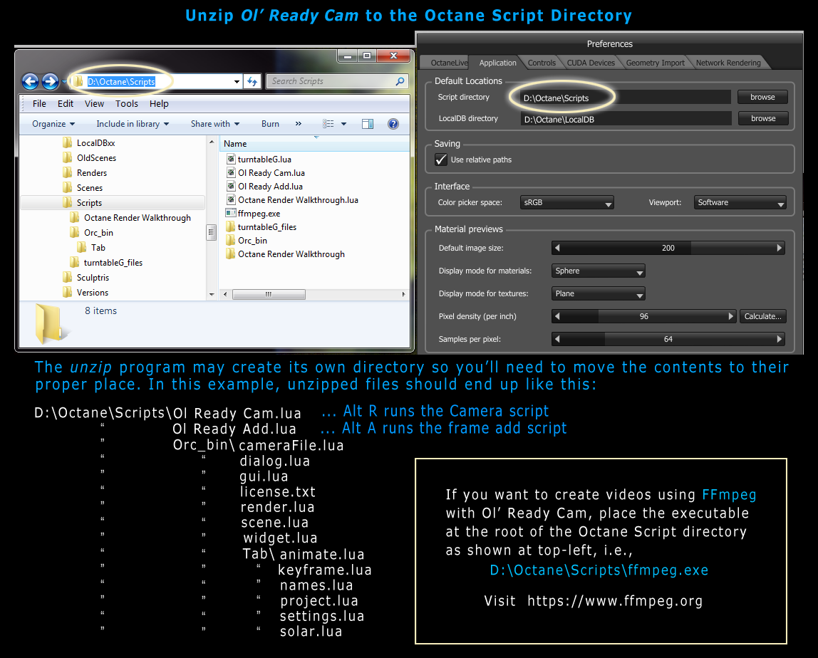

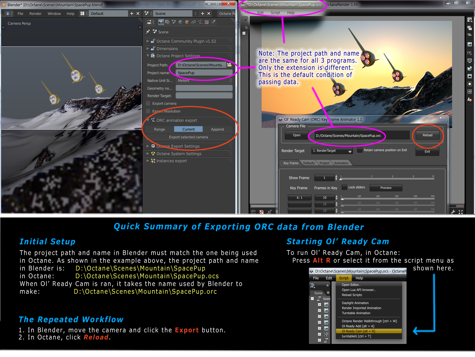

Script Installation
Here are a couple of quick images showing installation of the Lua scripts and Blender addon. See below for a PDF which goes more in-depth with some usages notes.
Quick Summary of installing the Lua scripts
Quick Summary of using Blender with Octane

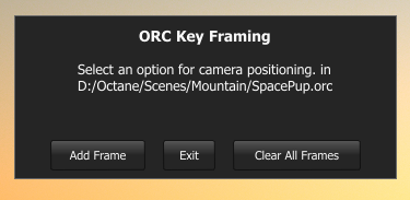

Creating Key Frames
So now the repeated workflow for adding frames is this:
  • * Move the camera to the desired position and click with the camera picker if needed.
    * Press Alt A to get the dialog box
    * Click Add Frame.

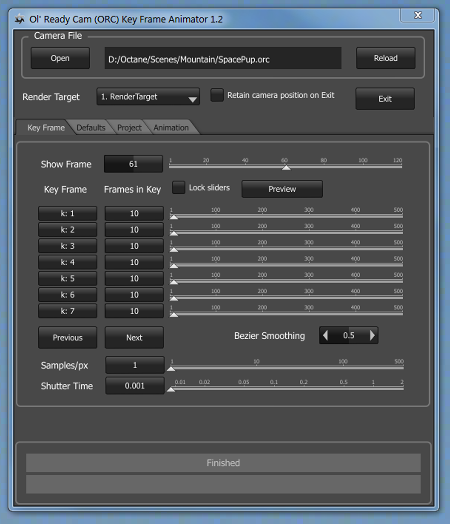

The Main Script
After having added the desired number of frames:
  • * Press Alt R to run Ol' Ready Cam.
    * Sliders and preview buttons in the Key Frame tab will give immediate feedback for the the frames you created with Ol Ready Add. At this point it is best just to explore the tabs and functions. It is suggested that you keep a render target using the Info channel kernel with shading normals available as 1 sample ppx can create a quick clean render for quickly viewing an animation.
Ol' Ready Cam
Ol' Ready Cam
