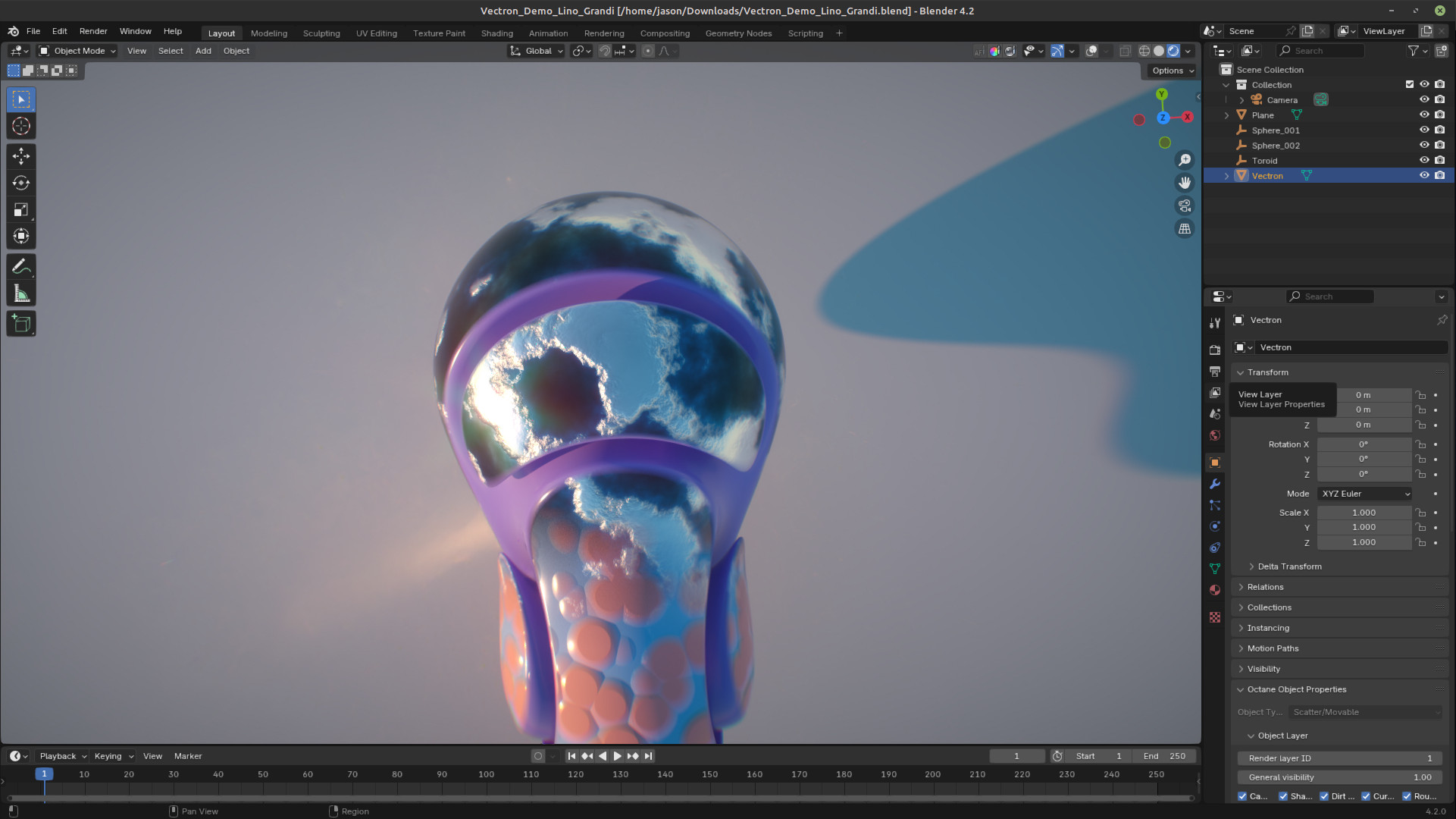

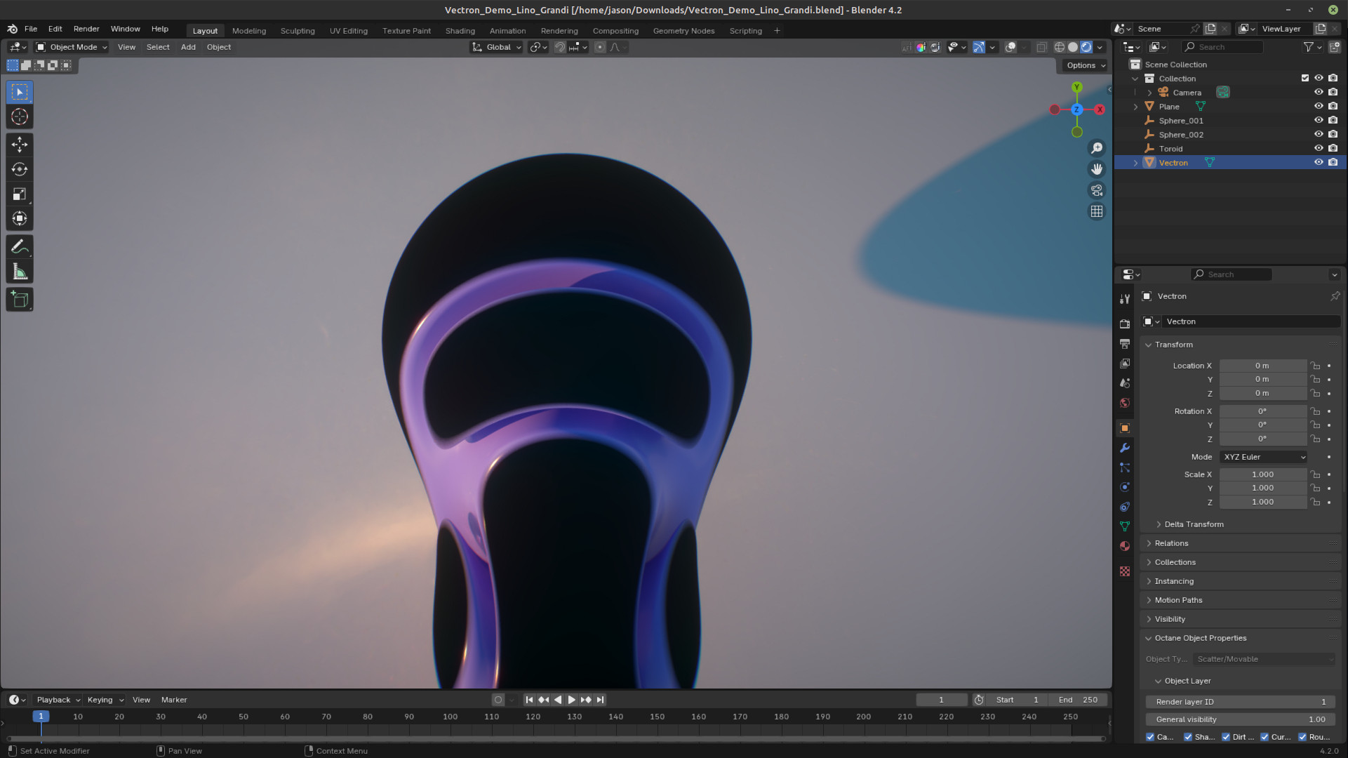

Thank you for the example, looks great. I only had an issue when I was looking at the example and choosing to look at it along one of the major axis. This might only be an issue with the viewport as I wasn't able to reproduce it with the camera. Here is an image that is shown along the Z axis and the textures disappeared. Then in the second image I just moved the viewport a tiny bit off axis and they re-appear.
Edit: I figured it out, I have Blender set to go into orthographic view when I look at a major axis. So I tested it with other viewing angles, and sure enough, the textures disappear when in orthographic view.

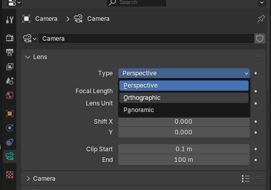

It doesn't look like you can create a camera with an orthographic view? Under the type drop down there is no Orthographic option.
Linux Mint 21.3 x64 | Nvidia GTX 980 4GB (displays) RTX 2070 8GB| Intel I7 5820K 3.8 Ghz | 32Gb Memory | Nvidia Driver 535.171
linograndiotoy
Posts: 1538
Of course you can. You're just looking into the wrong place. ;)
