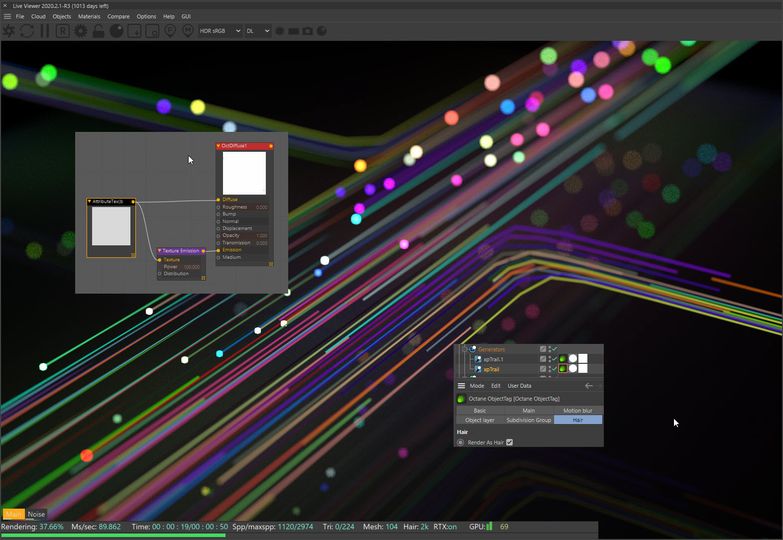

Is it possible to get per-vertex color data from splines yet? This would particularly be helpful in x-particles where trail splines can change color based on certain criteria that would be very difficult to match with w-coordinate

There's not any attribute that contains color for vertexes of splines. xpTrail is a special object and latest build has support to read this data. See my example for that.

Hi @aoctar please are you aware of bug while I use a deformer with xpTrail object which has color stored please? With deformer the Octane does not render stored colors
Posts: 16068
Location: Türkiye
Ofcourse wrote:Hi @aoctar please are you aware of bug while I use a deformer with xpTrail object which has color stored please? With deformer the Octane does not render stored colors
Yes, check my past answers.

Hello, I have installed recent version of Octane and I have found out that this bug is still in this version, are you aware of this bug being really bad? Let me know please.
