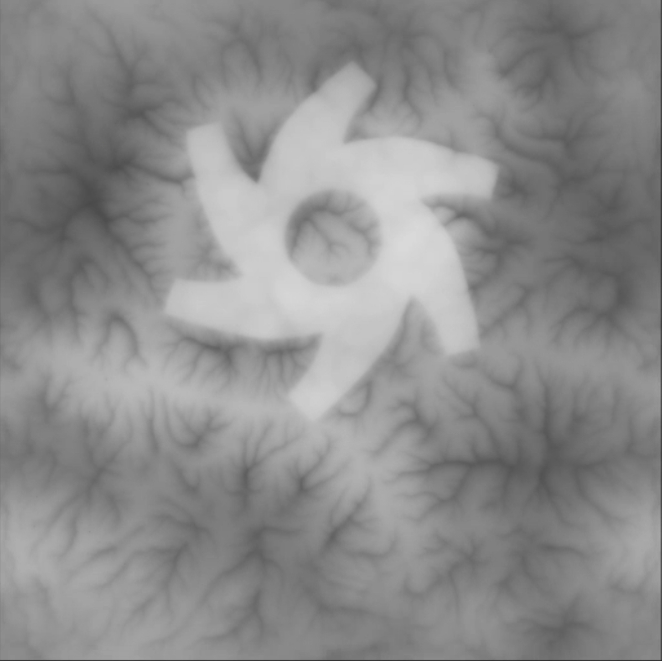

Hi there,
I don`t find the answer in the Forum. So here is my question:
How can I render a top view of, for example, a mountain in order to get a high quality greyscale depth map / height map?
I want to create 4k-8k highly detailed maps in order to use them later in octane for displacement.
What is the best workflow for that?
I attached a file. I wanttocreate something similar out of Cinema 4d for octane.
Greets

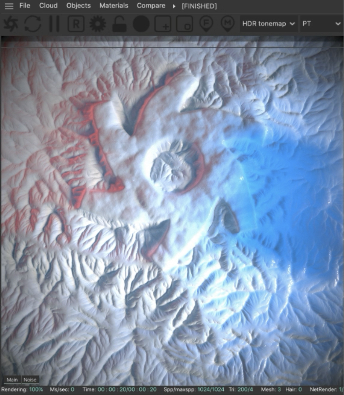

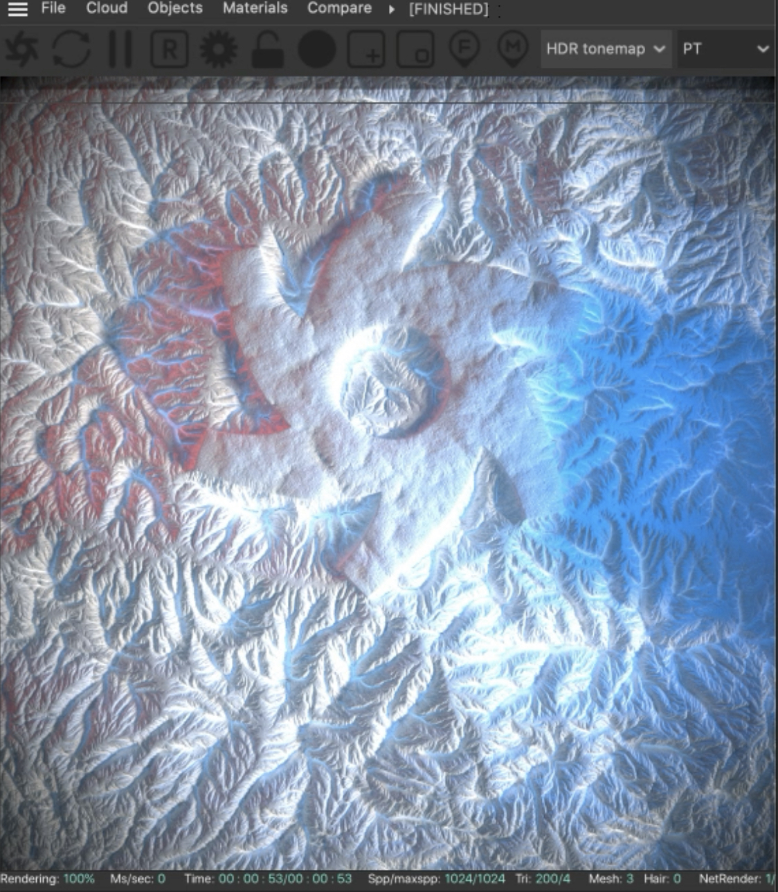

Please look at this example of a displacement map obtained with World Creator, and rendered in c4doctane:
Beauty from World Creator

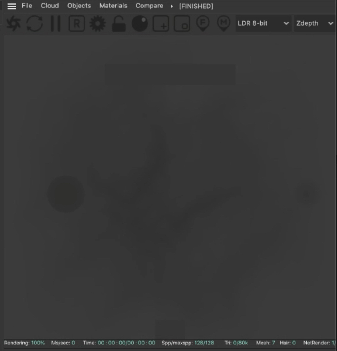

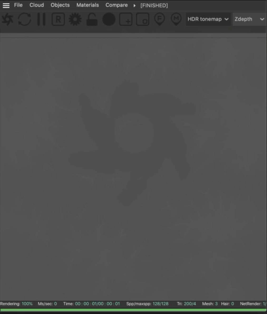

Than the Z depth pass of the same render:
Z depth pass
Z depth pass

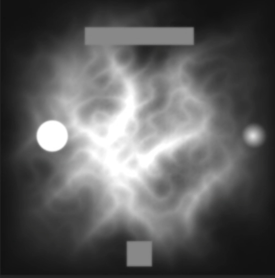

Then the same pass corrected in PhotoShop, by applying a 3D Bump/High filter to invert the Z depth pass, and a an Exposure offset, Gamma correction:
Photoshop color correction

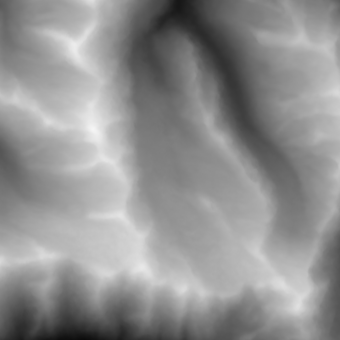

And finally used as displacement map in c4doctane:
final Z depth displacement result
A lot of details are lost, but it is possible to use it in world Creator to bring back the details.

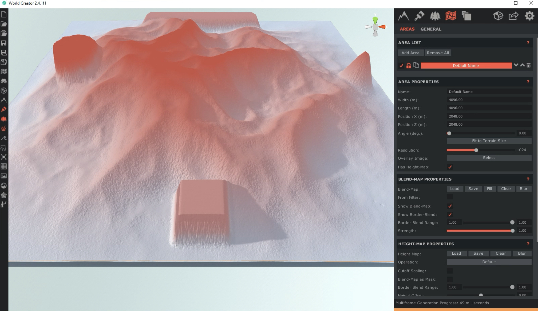

World Creator isn’t an option if you want to create heightmaps from your own geometry (either landscapes or from a hard modeled object). At least I can’t see any option in World Creator to import one’s own mesh.

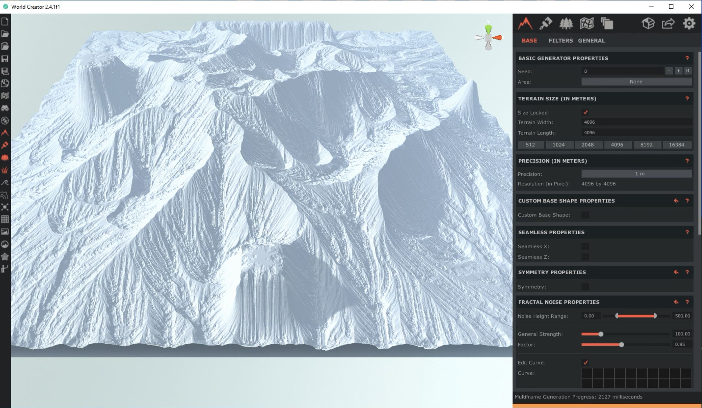

You can do something similar by using the Falloff node in 90° mode, but I prefer to use a top Orthographic Camera, in Z pass mode, the use the 3D/Bump-High filter in Photoshop, to have a rough Highmap to be used in World Creator:
c4d viewport
c4d viewport
Top Z-Depth pass
Top Z-Depth pass
after Photoshop filter
higmap imported in World Creator
to add some filters
to add some filters
ciao Beppe
