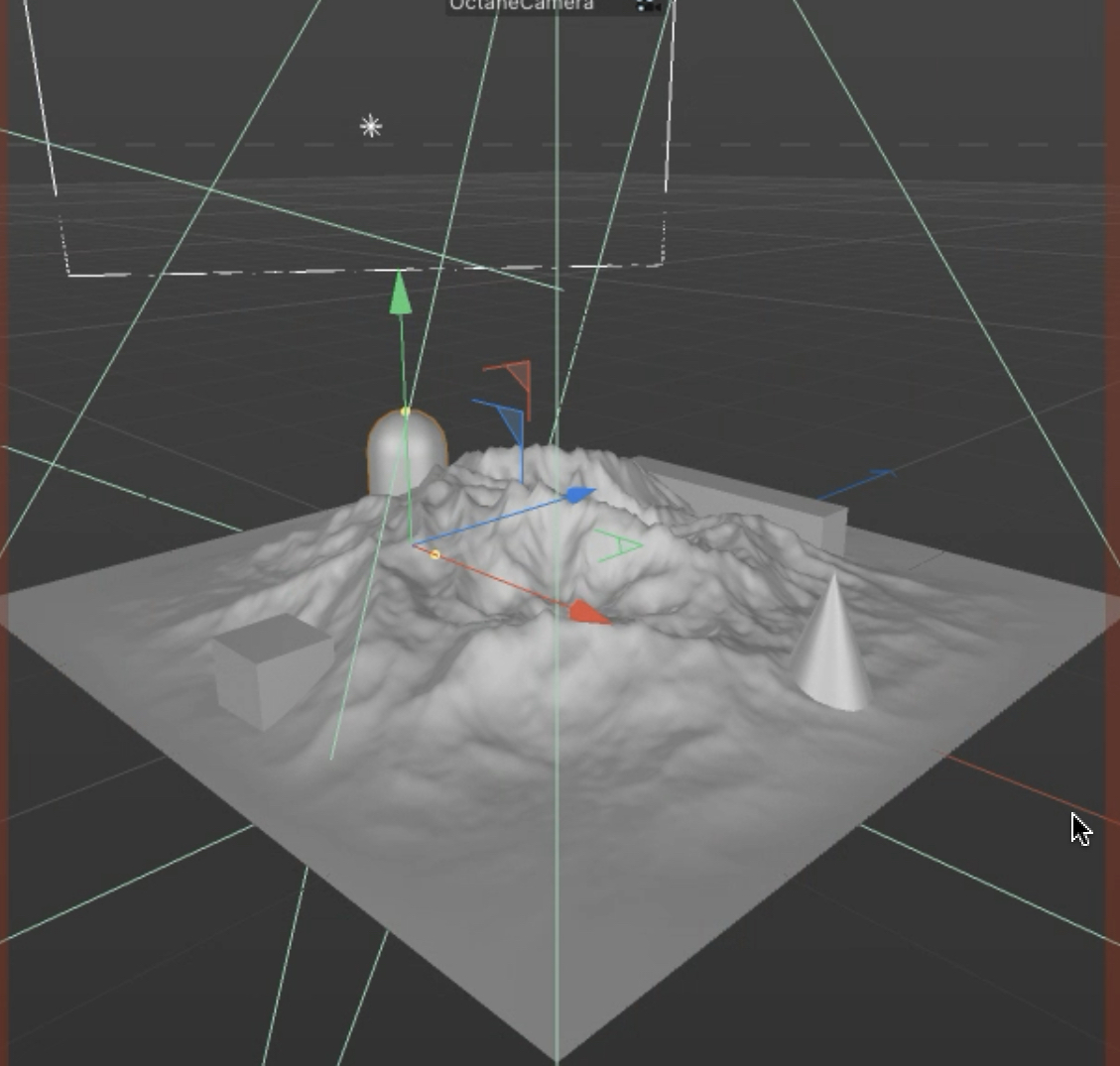

How can I render a top view of, for example, a mountain in order to get a high quality greyscale depth map / height map?
I want to create 4k-8k highly detailed maps in order to use them later in octane for displacement.
What is the best workflow for that?
I attached a file. I wanttocreate something similar out of Cinema 4d for octane.

You can use the Z-depth pass, have a look at this old experiment made 10 years ago:

Please look at this example of a displacement map obtained with World Creator, and rendered in c4doctane: Than the Z depth pass of the same render: Then the same pass corrected in PhotoShop, by applying a 3D Bump/High filter to invert the Z depth pass, and a an Exposure offset, Gamma correction: And finally used as displacement map in c4doctane: A lot of details are lost, but it is possible to use it in world Creator to bring back the details.

You can do something similar by using the Falloff node in 90° mode, but I prefer to use a top Orthographic Camera, in Z pass mode, the use the 3D/Bump-High filter in Photoshop, to have a rough Highmap to be used in World Creator:
