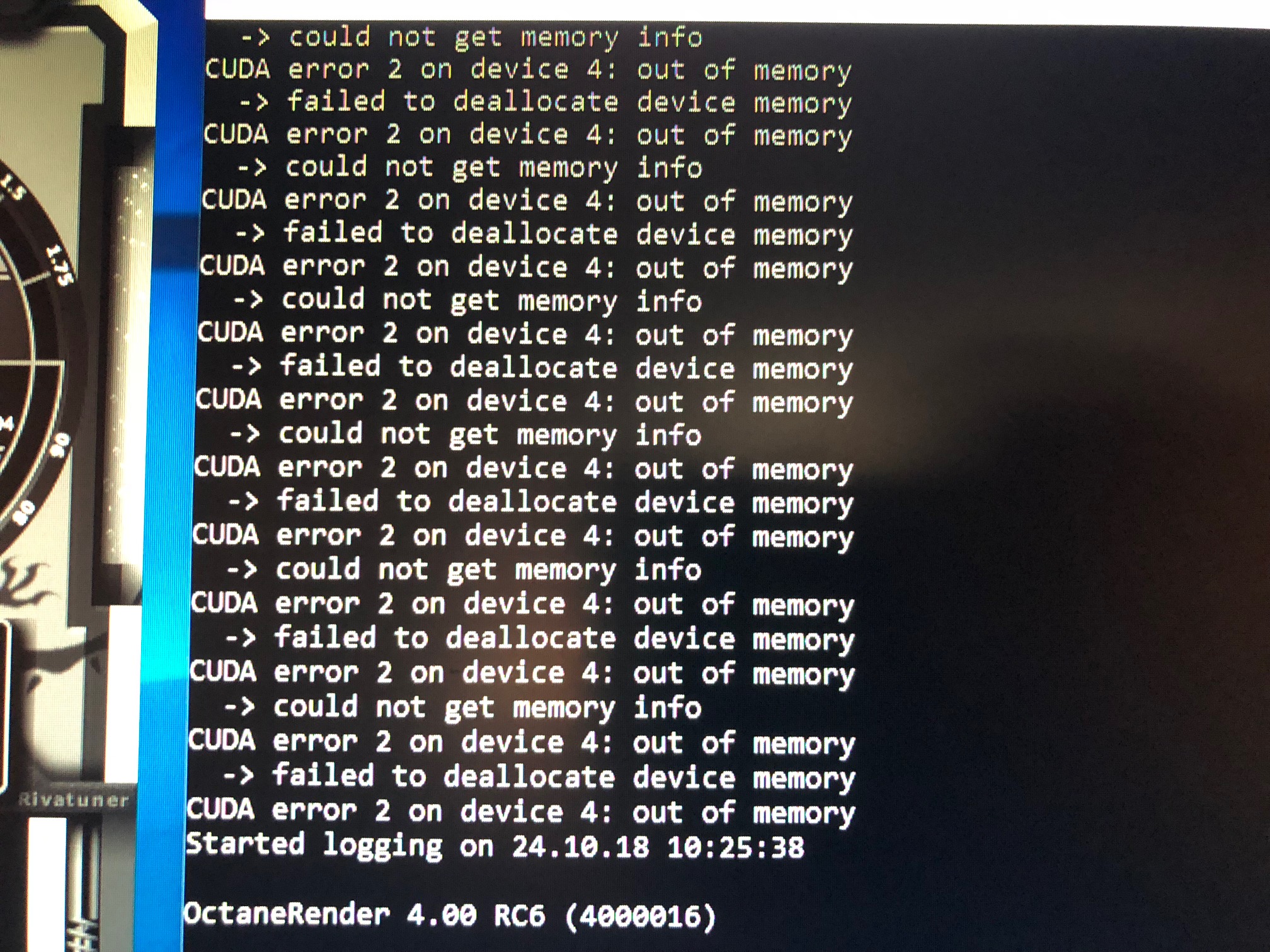

one of my slaves (3gpus + 4 gpus in netstor box, 1080s and titans xps) constantly has an error "out of memory". Even when I enable out of core. All other slaves work fine. Motherboard is ASUS ROG Rampage VI Extreme LGA2066 DDR4 M.2 U.2 X299 EATX Motherboard with onboard 802.11AD WiGig Wi-Fi USB 3.1, 32 gb of ram, i9-7900x abd nvme for 250GB only. Windows 10 PRO
It happens a lot after octane viewport is used and then rendering begins. I really think it has something to do with ASUS boards too, PLX chips, etc. This is the same PC that would just freeze without any errors. Complete freeze. This is the only slave that has 7 GPUs others have 5, 3 and 3
Four slaves are connected to the netgear 10 Gbit switch. And this is the only slave out of 4 messing up. Other slaves have the same video cards 1080s, titans and one more netstor box. This is the only slave with built in 10 Gigabit port. Others have intel 10 Gigabit network cards installed

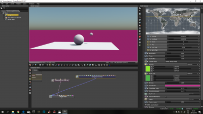

Nishita Daylight Model
I do not see any effect when adjusting the Sky Turbidity parameter.

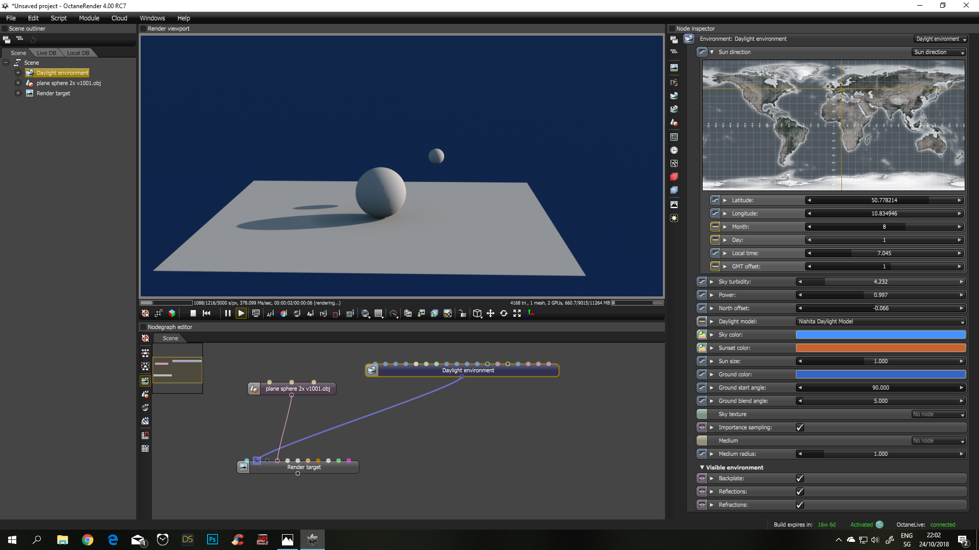

Update / Edit:
Not seeing an effect when adjusting Sky Color and Sunset Color as well in the Nishita Daylight Model.
Any other parameter that needs to be adjusted in combination?
Or are those parameters simply not used in the Nishita Daylight Model?
In the New Daylight environment adjusting Sky Turbidity alone shows a huge difference in shadow softness as expected. Sky and Sunset Colors also change drastically as expected.

Nishita Sky does not work with sky color and sunset color given that it is a physically based model. Turbidity however should work, I'll look into it.
