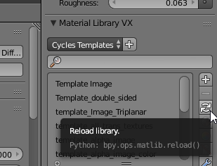

Hi J.C,
Thanks for your tests. Add/remove works for me. Could you please try to refresh the libs?
PS: To get rid of typing commands every time, you can put the code in a shell script under the blender folder. Then run blender from the script instead of the blender.app as workarounds.
Cheers,
DrawFun
Code: Select all
#!/bin/sh
echo "Start blender from terminal..."
DIR=$( cd "$( dirname "${BASH_SOURCE[0]}" )" && pwd )
cd "${DIR}"
./blender.app/Contents/MacOS/blender
DrawFun
