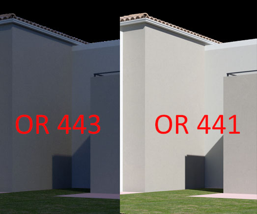

I mean for my case...
@Paride : Is there a problem with 443 vs 441 ? I can't have the same render with same scene.

Hi Paride.
I send you a scene which render differently with 4.41 and 4.43. This is a hdr problem as with another hdr OR render identically with both 4.41 and 4.43.
But it is strange that renders are different with 4.41 vs 4.43. To re-render the scene I must switch to 4.41.
HDRI is from HDRIheaven https://hdrihaven.com/hdri/?c=clear&h=flower_road

HHbomb,
you're right, 4.41 and 4.44 work differently.
I tried exporting to SA, the issue is as follows:
4.41 has default input 32bit and 4.44 default input is 16bit.
My advice, waiting for Octane 3dsMax plugin 3.08 SDK (I think a handful of days), is to use 4.44, export to SA and switch to 32bit before render.
We absolutely need a 16/32bit RGB image option in Octane 3dsMax plugin.
I will make sure that developers do not forget it.
Regards
