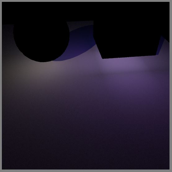

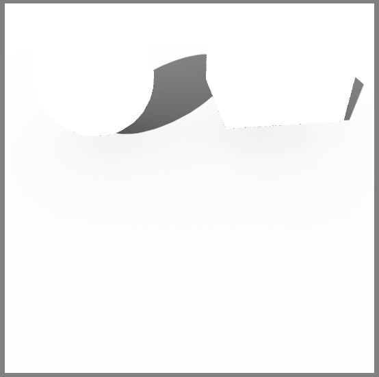

Noise on edges of Shadow Passes

Devs - please confirm: this is still a problem, even in 2019.1 XB2, right?
Posts: 10491
The residual internal noise will be covered by the beauty pass on top.
What is important is to have a clean result outside of the alpha of the Render layer, for shadows and reflections.
