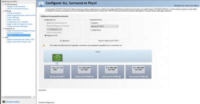

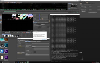

I am sending you the screenshots, when the scene freezes and strength cinema 4d to leave.

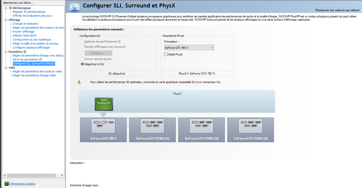

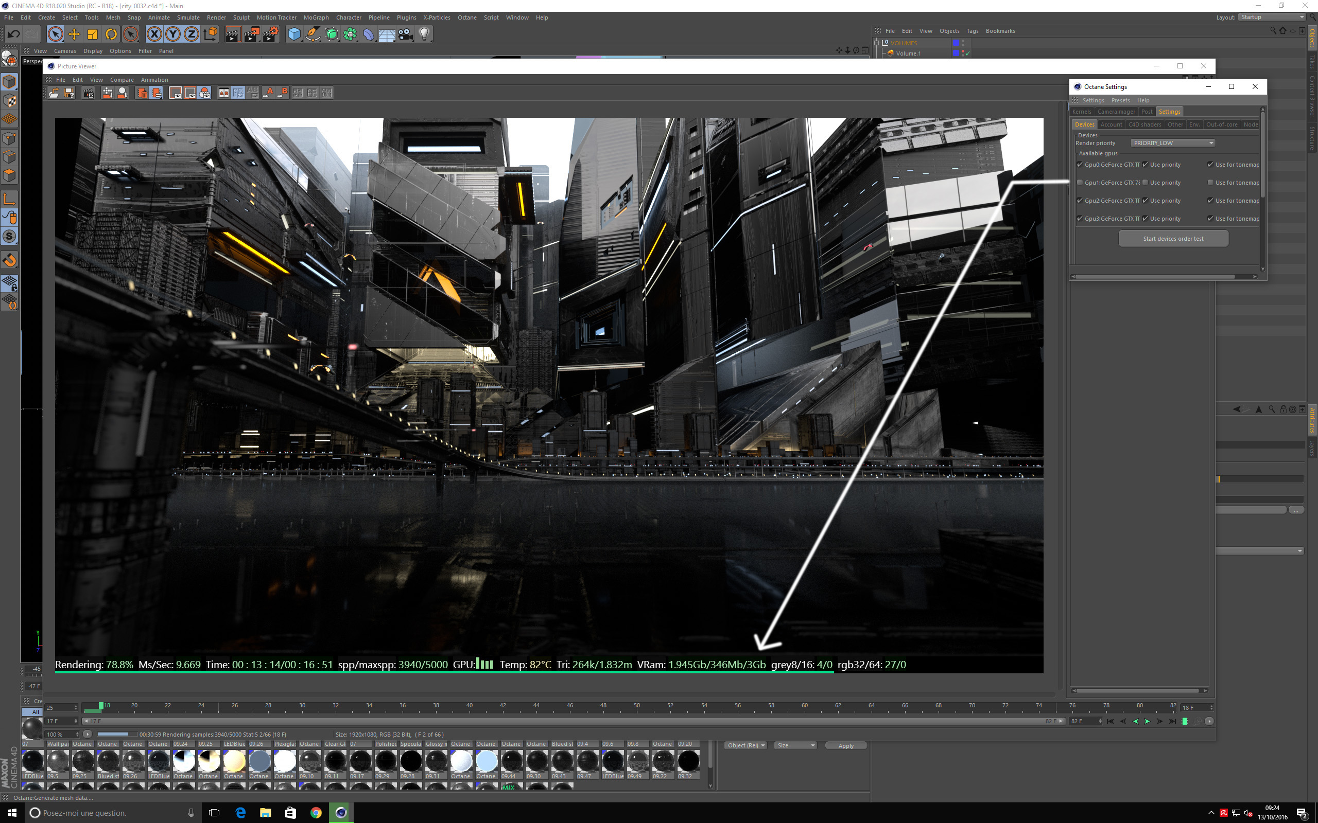

In the first document i saw that, even if i disable the 780 ti it seems that Octane continue to see only 3gb of ram available.

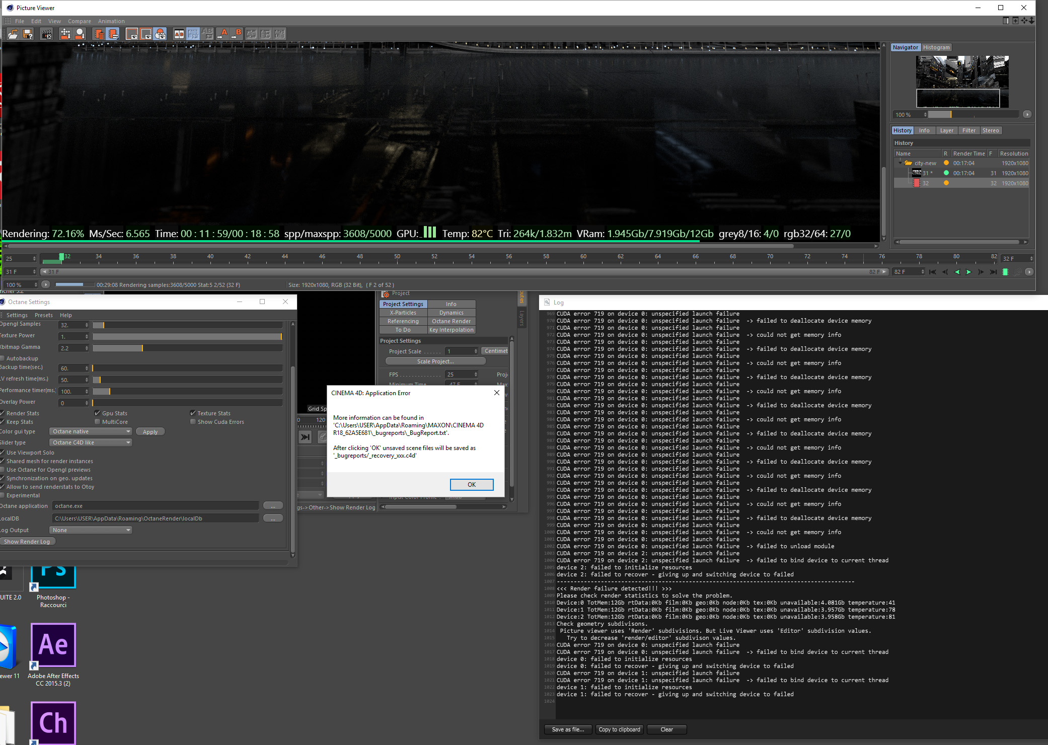

In the second i made a screen capture of the entire scene and the messages in the logs window.

Please check in your Nvidia control panel if "Multi GPU" is active, if yes disable it while working with Octane, SLI can couse errors and issues with VRAM.

hi.. so i disabled the 780 ti from cuda in the Nvidia panel, like this i only see the three TITAN X..
SLI is not enable ... but i still have a "crash" see the attached file

My main problem here, is that i can't do anything when C4D crash, i can't even copy past to the clip board the bug report.. that's why until now i give a screen capture

this is a problem on low level. Maybe driver/hardware or renderer.
1-You can find bugreport.zip. It's visible in your screenshots.
