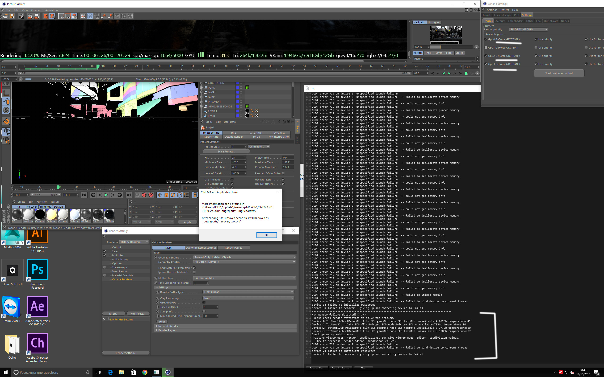

I am sending you the screenshots, when the scene freezes and strength cinema 4d to leave.
In the first document i saw that, even if i disable the 780 ti it seems that Octane continue to see only 3gb of ram available.
In the second i made a screen capture of the entire scene and the messages in the logs window.

this is a problem on low level. Maybe driver/hardware or renderer.
1-You can find bugreport.zip. It's visible in your screenshots.
2-You can send C4D scene to us.
3-You can go to LV->File->Export->Animated ORBX to export whole animation as orbx.
