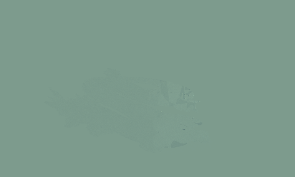

Hi, guys.
Dragon invisible test at resolution screen of 1002x602:
-- v3.01.1b:
-- v2.25:
I get caustics later using v3.00~v3.01.1b at same samples per pixel (S/px or spp). :? :(
PMC default settings except few things - see right of 1st image
Specular material for dragon default settings except:
- reflection and transmission 1.000
- índex of refraction 1.000
I hope the caustics will be better/earlier than v2.2x or this issue will be fixed to undo as v2.2x.

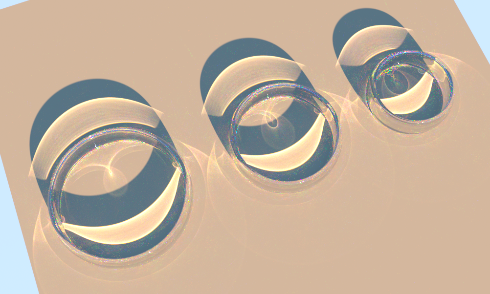

Wedding glass test:
-- v2.25
wedding@1002x602 - daylight-08h@50diff+52spec-depth,10k-reject_151705 spp-7h56min.png
-- v3.01.1b
wedding@1002x602 - daylight-08h@50diff+52spec-depth,10k-reject_151705 spp-4h58min.png
PMC default settings except:
- 151705 spp
- 50-diffuse and 52-specular maxdepth
- 10k-reject
- parallelism 1
- caustic blur 0.000
v2.25 is better caustic = more realism than 3.01.1b (look 3rd ring on right) but v3.0x is ~2x faster than v2.25.
See caustics "cleaned" for v2.2x only. :)

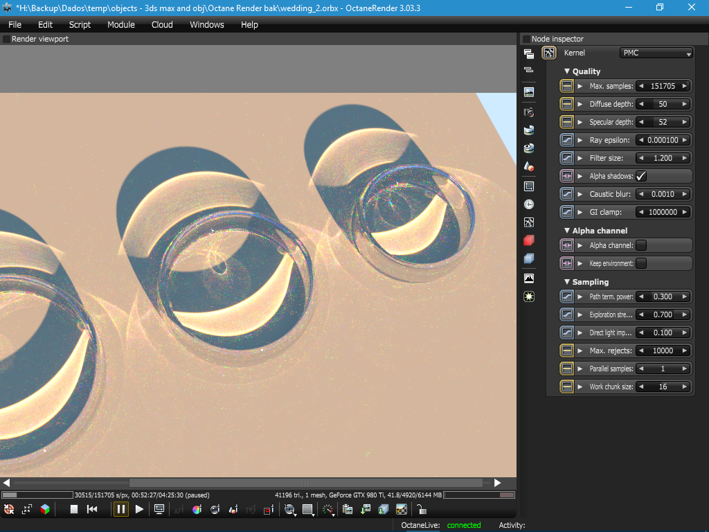

Wedding test - caustic blur 0.001:
-- v3.03.3
-- v2.25
v2.25 continues to be better and more visible caustic (3rd ring on right). I prefer v2.25 until the issue fixed. ;)
