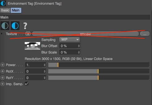

in c4dOctane, never load directly an HDR in the texture node:

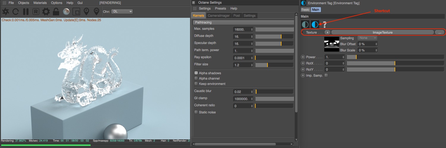

but, always use an Imagetexture node before loading th HDR, in this way you have a better control on the Gamma and the illumination values are correctly transfered to Octane. Here is your scene with gamma at 1:
there is also a shortcut button that automatically loads the Imagetexture node ;)
