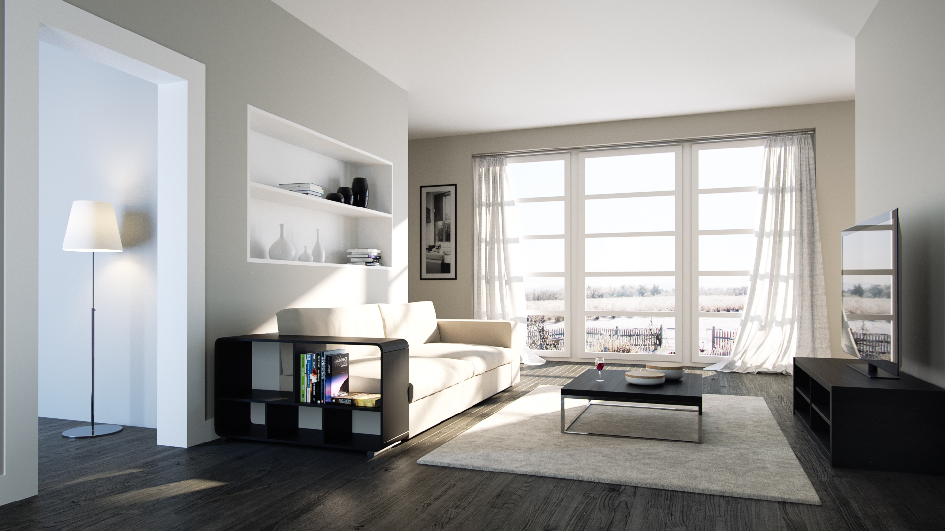

This is my version
every parameter is tweaked
regards
regards

quad Titan Kepler 6GB + quad Titan X Pascal 12GB + quad GTX1080 8GB + dual GTX1080Ti 11GB
@ Gabriele: Thanks! But speedwise it's a lot slower/noisier now.
@ noel: Please don't do this

- gabrielefx
- Posts: 1701
- Joined: Wed Sep 28, 2011 2:00 pm
photorealistic vs speed balance is hard to find.
In your scene you clamped all caustics and glossy+diffuse bounces are set to minimum.
Also highlights are clamped to 1.
In interiors I set glossy and diffuse to 10 or 12, for exteriors 5-8 and caustics can be clamped because the sun generates visible fireflies hard to delete with the pixel filter.
I never create materials with diffuse shaders except when I need translucency for thin surfaces. For plants I alway mix diffuse and glossy.
For example the curtain material is wrong. There is no transparency. In reality we should add an opacity mask or mix a diffuse shader + specular with roughness set to 0,1 and index set to 1.
