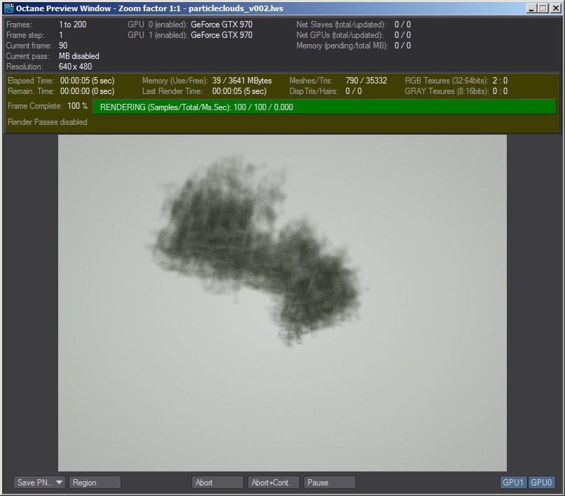

mikefrisk
Posts: 172
Joined: Fri Aug 29, 2014 9:17 pm
Sure!
Sorry for the super low res render, these only took 5 seconds a frame.
I originally developed this to use for semi-static clouds and tornado's. The producer ended up using some quick/cheap stock footage so I scrapped it.
I could have used more "textured squares", this one only has one. And I could have animated the texture and brought it in as a sequence, but i didn't.
If I end up working on this technique more i'll post my findings in this thread.

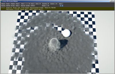

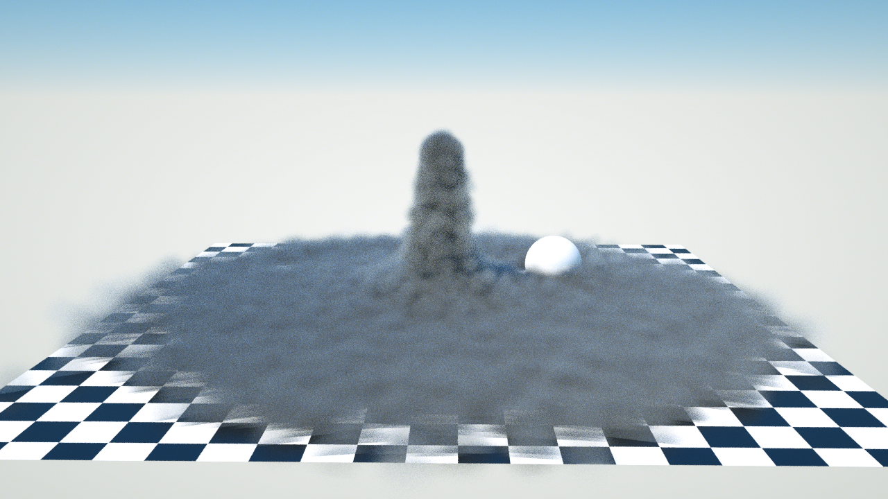

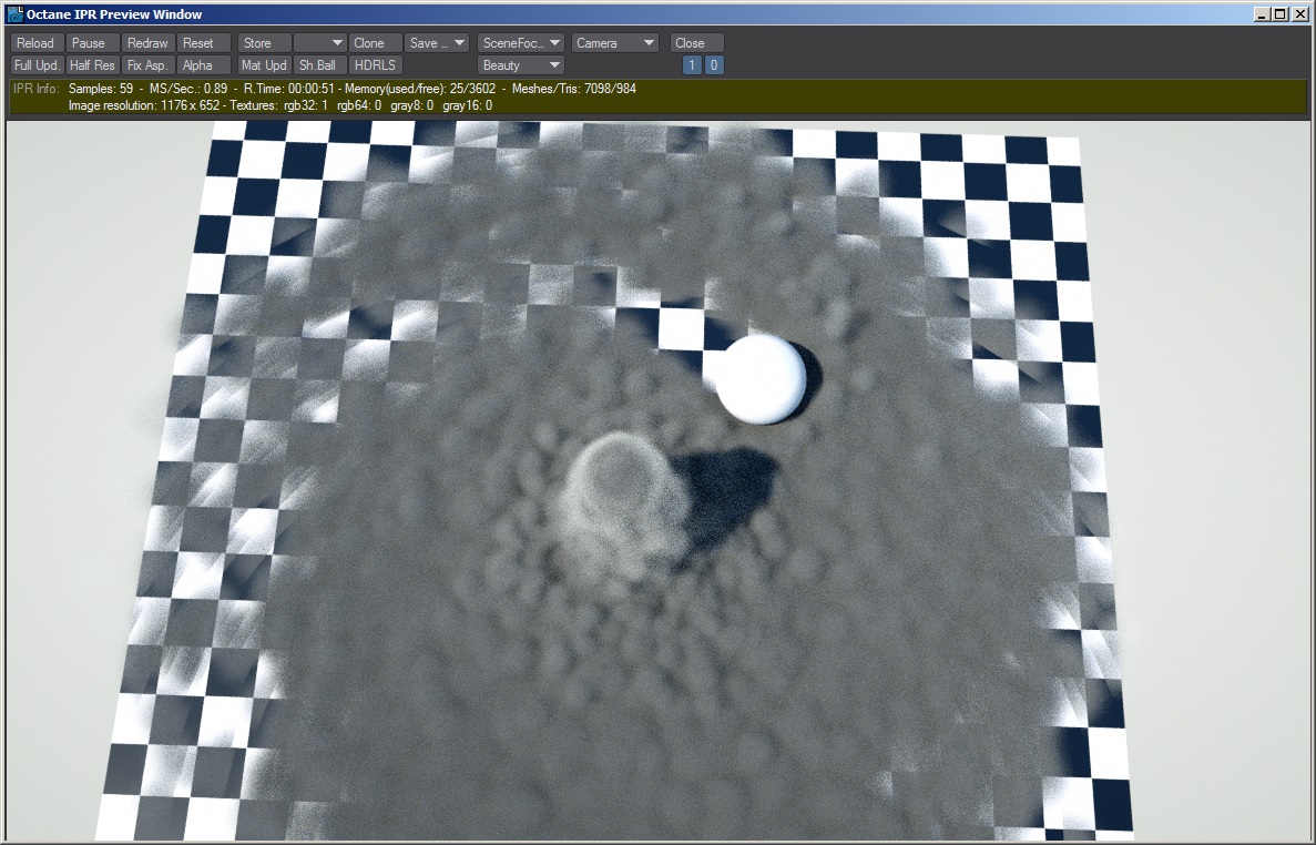

mikefrisk
Posts: 172
I simplified it a bit. The shadows get weird at certain angles, but I think I know a way to fix that.
Oh, and sorry for the grain, I kept the render times short.
