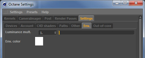

Posts: 16068
Location: Türkiye
i think problem is different "default env color" for each plugin. Check your settings as in picture.
