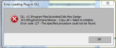

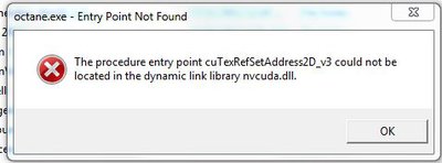

I am getting error messages [attached] whenever I try to launch Octane Standalone or plugin for 3ds max. I have followed all of the guidelines, so far as I can tell, and I have the right hardware software.
Specs below:
Machine: HP Z1, 16GB RAM, 500GB hard disc
OS: Windows 7
GPU: Nvidia Quadro 3000M [CUDA]
Any suggestions?
3ds Max Demo not working
Try uninstall Quadro driver with reboot required and install with clean option (may reboot) new version of this driver WHQL.

Cuda Toolkit is located on the Nvidia site and you must install it before you install the system on Octane Render
- MathewWindebank
- Posts: 3
- Joined: Sun Apr 27, 2014 12:44 am
Thanks Amirsaeed Khaki, loading the CUDA toolkit worked. I don't understand why this isn't mentioned in the FAQ's or anywhere else.
