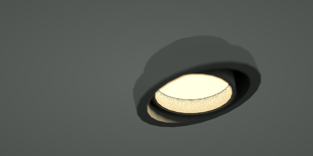

Pavlov
Posts: 158
Joined: Fri May 21, 2010 8:49 am
hi,
normals were facing inwards before i flipped them, but even that way emitters didnt work.
Tweaking parameters i managed to get emitter bright (they were visible) but they didnt cast light.
If they cast any light, it must be extremely slow to show because it's not there after 4 min on a GTX 470.
How long simplified scene above took to render ? Did you see lighting immediately or did it show after some minutes of refining ?
thank,
Paolo
I7 960 3.2 GHZ - 6GB ram - GTS 250 display only - Asus GTX 470

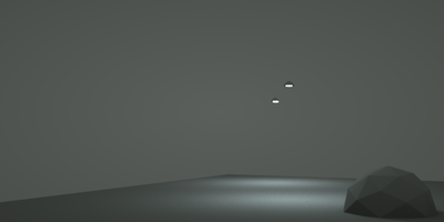

Henrik
Posts: 123
Joined: Thu May 13, 2010 1:22 am
Location: Oslo,Norway
immediately,it was a 2 sec render
Asus p67|Windows 10|GTX970_GTX1070|i7-2600K|16GBRAM
