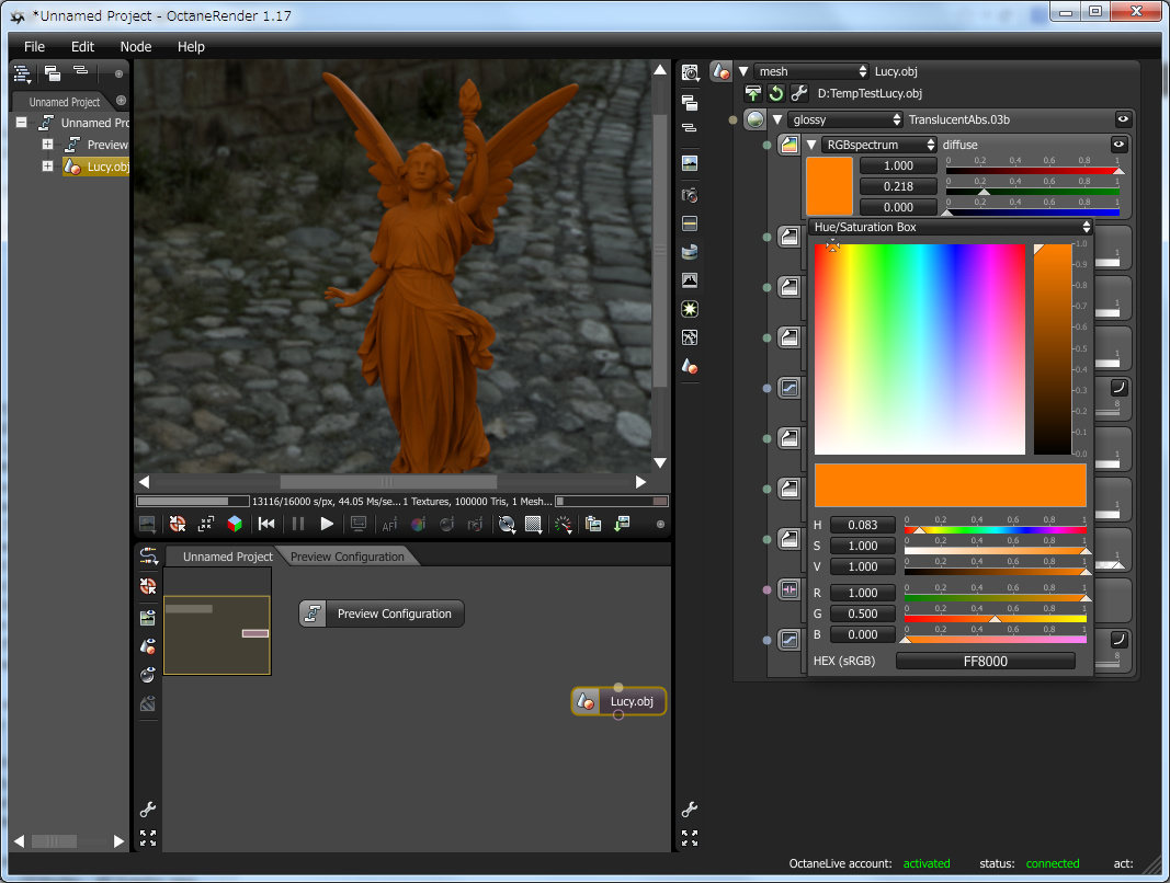

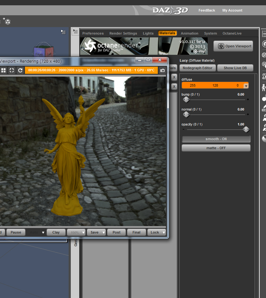

This is a comparison of the plug-in version and the stand-alone version. In the stand-alone version, FF8000 has been converted to (1.000,0.218, 0.000). However, it has been converted to (1.0,0.5,0.0) in plug-in version. For this reason, it does not seem to show the correct color.
It would be cause it has not been gamma correction. I expect that it will be fixed.
Plug-in version.
Plug-in version.
Standalone version.
Standalone version.

you are right; apparently the api takes the upper value (whatever this is) instead the rgb value - as the daz (=windows) color dialog sends plain rgb fractions (80 hex =~ 0.5), this indeed leads to a wrong color input. need to check that with otoy...

thank you markus, but if fact the plugin is responsible for that; there is only a sRGB color picker from the host to input values, so i need to do the (missing) sRGB to linear calculation; currently testing it (so you can most probably scratch my post in the dev forum)...

should be fixed with the next update, which is expect to appear in*
sRGB is converted to linear internally, means the daz color picker input should result in similar colors in octane.
