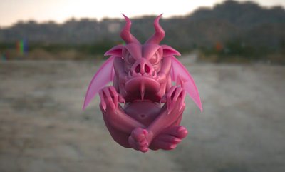

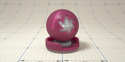

Hi Guys,
I added a glossy reflective SSS material I created earlier.
You can find at Live DB. Organic/Skin under the name Reflective SSS.
Let me know if you come up with nice renders with it.

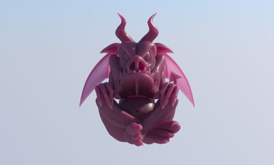

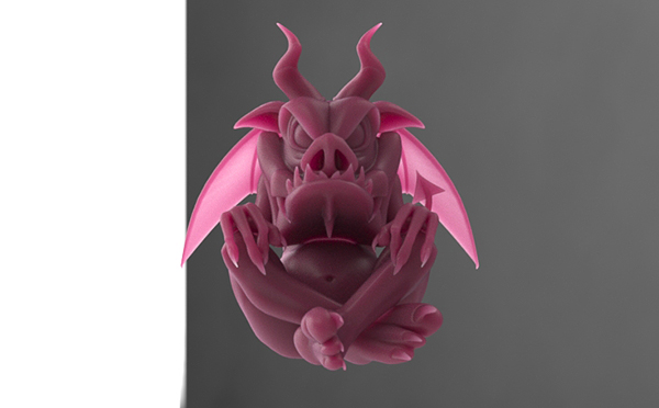

cfrank78 Hi,
Apparently, there has been mess up with the scale conversion with octane and max simply because of unit setup.
But the solution is simple. You need to lower the Scale of the Scattering Medium down to 50-100 ish..
It will always vary depending on your scene scale...
You can see a very quick messy preview render from max as a proof as well :)
I also added two hdri environment, daylight lighting renders in Max.
