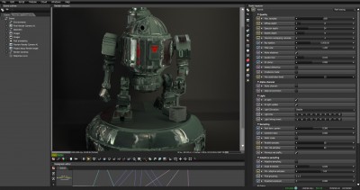

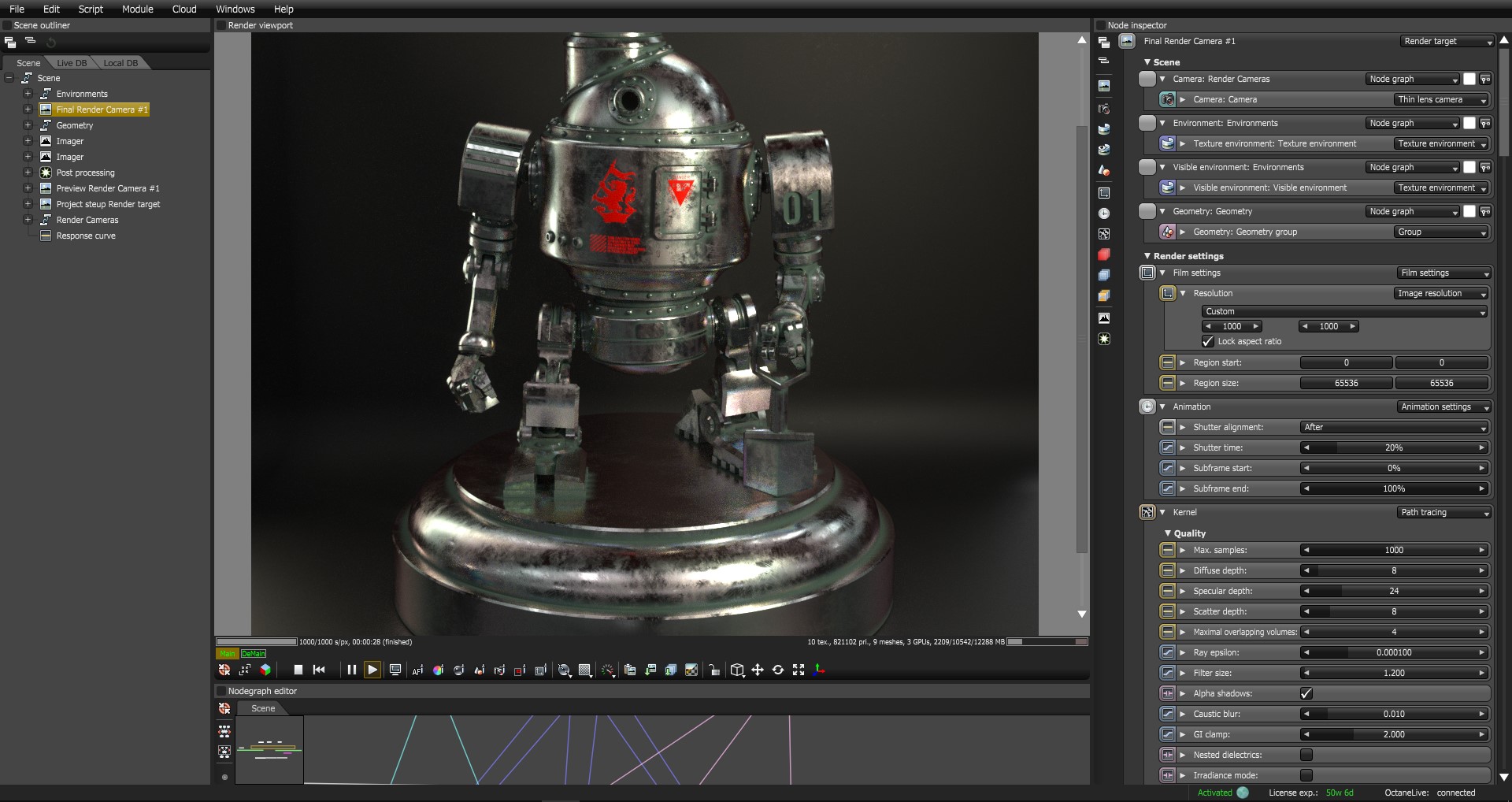

Out of the box:
Same scene has very different looks when opened in OC 2021 and OC 2022. Refer to images.
Regards,
2022 looks terrible, something is going on
2021 looks great
2021 looks great

Kalua wrote:Out of the box:
Regards,
Can you PM me the scene so we can take a look at it? Thank you.
Kalua
Posts: 571
Location: Caribbean Sea
Regards,
I sent you trough PM.

noldo
Posts: 95
Joined: Wed May 25, 2011 7:07 pm
Regards,
FBX model I suppose.
Try to toggle "Load vertex normal", is buggy.

Kalua
Posts: 571
Regards,
Thank you, noldo.
But it is a no go. Toggling "load vertex normal" didn't help - same faulty result.
It is an .orbx file.
Regards,
C4D 2025.3.3 Octane v1.9.4 // Octane SA 2026.4, Windows 11 Pro, X399, AMD TR 2950X, <<2 X 3090 + NVlink>>, 128 GB RAM, Corsair 1500i - NVIDIA SD 610.62
