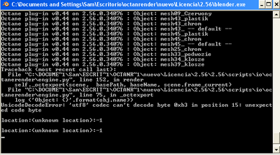

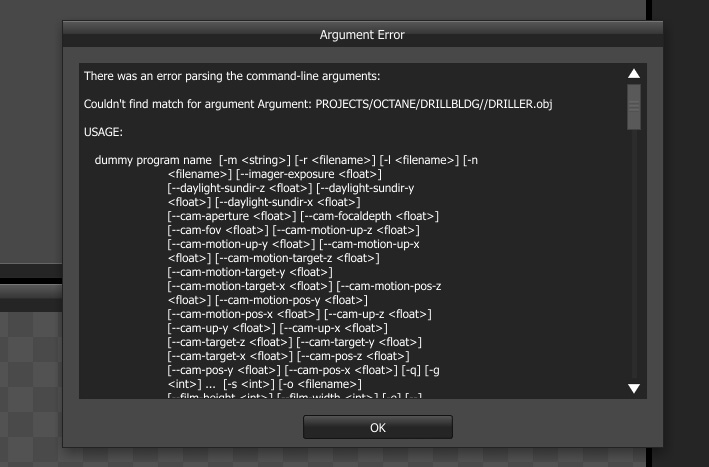

another matter, I get this error when I'm trying to render with Octane by the script:
EDIT:

Regarding your error, you have a special character in an object name. Disabling logs may work but I strongly recommend you rename properly the offending object.
