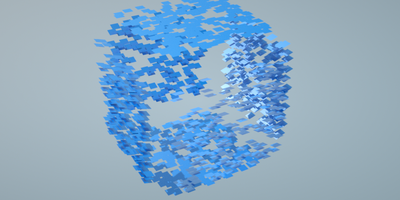

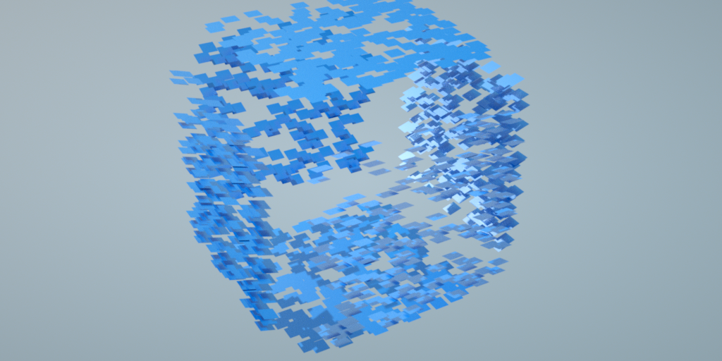

If you want to render particle meshes:
- set a 'Particle instance' modifier on the mesh you want to render
- avoid displaying the modifer, it'll slow down Blender a lot
- be carefull with complex meshes, it can exhaust all available memory (had to kill everything when trying to render a bunch of lvl2 subsurfaced Suzanne particles, 12GB of RAM was not enough...)

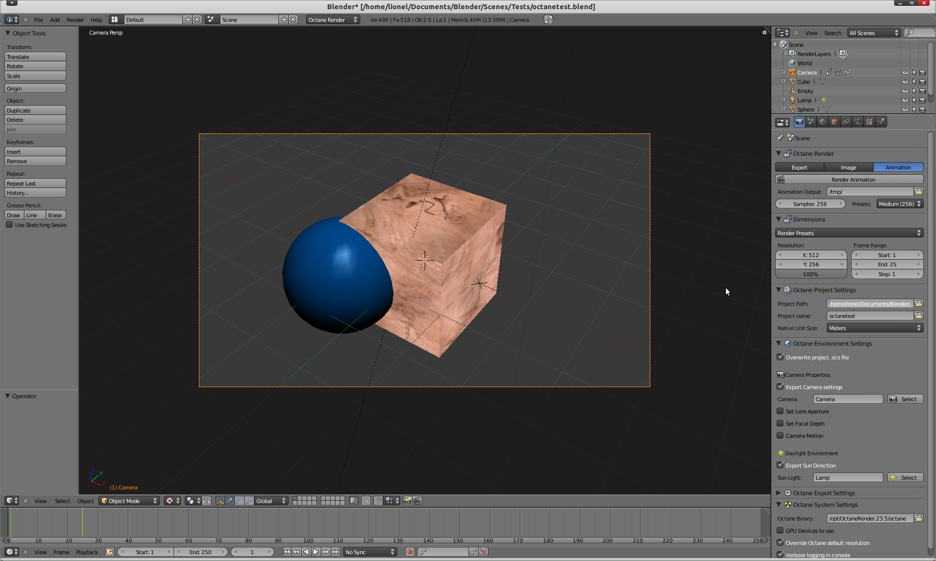

[EDIT] 2011-01-15: v0.60
*** warning - lots of changes, stability not guaranteed ***
  • - uses notification system from Blender
    - uses resolution from Blender's render, with functional presets. Allows fine camera tuning.
    - uses animation frame settings from blender's render
    - uses Depth of Field from selected blender's camera, using either distance or object and will ignore if 0.

*** install notes ***
  • - remove any previous version of the addon
    - download addon for your blender build (either 2.56a from blender or the other one for recent builds)
    - from blender user preferences, choose install add-on and select the zip file (no need to uncompress)
    - click on the addon check-box to activate it

What do you mean?
Do you have a .blend sample?
Desktop: Ubuntu 13.04 x64 - i7-3770K @ 3.5GHz - 32GB DDR3 - GTX670 2048MB
Laptop: Linux Mint 11 x64 - i7-2860QM @ 2.5GHz - 16GB DDR3 - Quadro 3000M 2GB
Software: NVidia 319.12 - Cuda 4.2.9 - Blender 2.66a
steveps3
Posts: 1118
Joined: Sat Aug 21, 2010 4:07 pm
Location: England
sure, very simply but find attached
(HW) Intel i7 2600k, 16GB DDR3, MSI 560GTX ti (2GB) x 3
(SW) Octane (1.50) Blender (2.70) (exporter 2.02)
(OS) Windows 7(64)
yoyoz
Posts: 451
Joined: Sat Dec 25, 2010 9:59 am
Location: Belgium
I don't see any attachment. You probably need to zip it first, I'll then have a look at it.
steveps3
Posts: 1118
Location: England
try again
(OS) Windows 7(64)
steveps3
Posts: 1118
Location: England
ok, third time lucky
particletest.zip
(91.69 KiB) Downloaded 619 times
(OS) Windows 7(64)
yoyoz
Posts: 451
Location: Belgium
OK:
- particle instance should be on mesh that is the particle, not the emitter
- you resized your plane object instead of resizing the mesh itself
Particle system working :D
