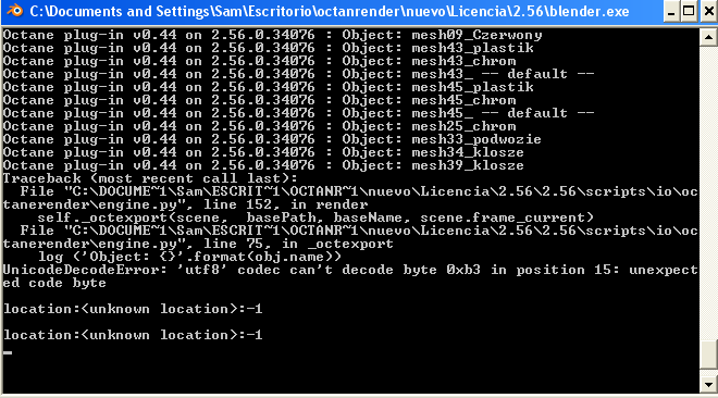

another matter, I get this error when I'm trying to render with Octane by the script:
groupsV2.zip
(62.43 KiB) Downloaded 387 times
yoyoz
Posts: 451
Joined: Sat Dec 25, 2010 9:59 am
Location: Belgium
I' m getting 3 cubes when rendering in both Octane and Blender (and not the plane). What's the expected behaviour?
Regarding your error, you have a special character in an object name. Disabling logs may work but I strongly recommend you rename properly the offending object.
