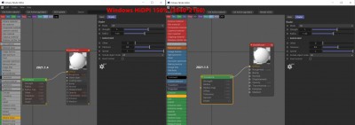

The text comes out blurry.
Windows 3840-2160 150% Scale
Cinema4D version 2021.1.5-(R4) (Stable 2021) 28.06.2022

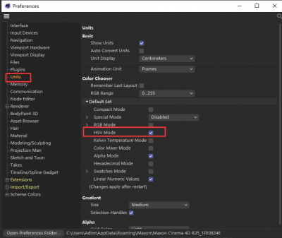

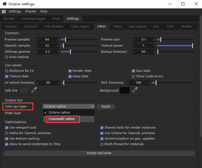

You can try the following:thanulee wrote:I d like to set HSV to default as well if possible!moebius wrote:oh, no!
Why did you changed that position? It's so far away. I prefere HSV and have tp change that so many times. Or is there a way to set HSV permanent?
1.Open Cinema 4D‘Preferences》Units》’,choice ‘HSV mode’
See 01 picture for details
2.Open‘Octane settings 》Settings》Other’,switch‘Color gui type’to ‘Cinema 4D native’,Click ‘Apply’
See 02 picture for details
HSV is now the default color mode.
The method may not be very clever
Thanks I always forget to change that! Its great method actuallyHurricane wrote:You can try the following:thanulee wrote:I d like to set HSV to default as well if possible!moebius wrote:oh, no!
