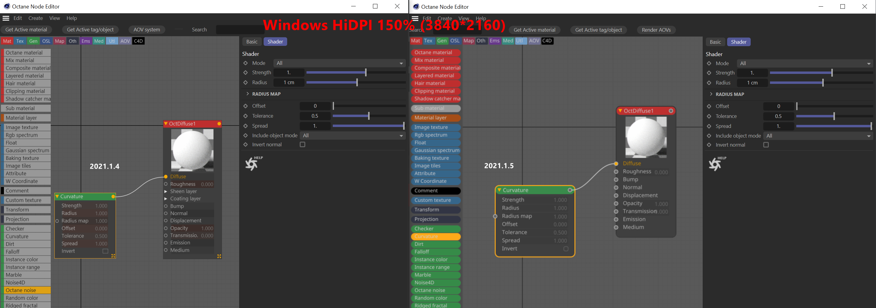

The text comes out blurry.
Windows 3840-2160 150% Scale
C4D R2026 / Win11 / AMD TR WX Series / 256Gb RAM / RTX 5090 FE / 100GbE
Posts: 16068
Location: Türkiye
eyeonestudio wrote:The text comes out blurry.
I know, not yet added scaling support

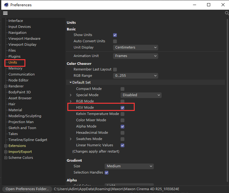

thanulee wrote:
moebius wrote:oh, no!
Why did you changed that position? It's so far away. I prefere HSV and have tp change that so many times. Or is there a way to set HSV permanent?
The attachment Bild_2022-05-16_145144768.png is no longer available
I d like to set HSV to default as well if possible!
You can try the following:
1.Open Cinema 4D‘Preferences》Units》’,choice ‘HSV mode’
See 01 picture for details
2.Open‘Octane settings 》Settings》Other’,switch‘Color gui type’to ‘Cinema 4D native’,Click ‘Apply’
See 02 picture for details
HSV is now the default color mode.
The method may not be very clever

Hurricane wrote:
Thanks I always forget to change that! Its great method actually

thanulee wrote: You can try the following:
thanks!
