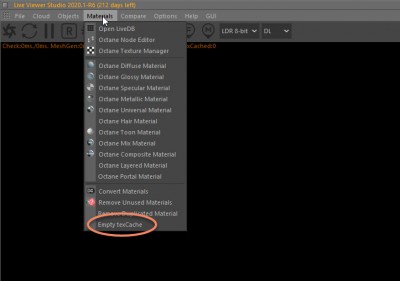

aoktar wrote:give a try and also use 2020.1-R6
Ok will do. Can you show me where that command is ?

The command I pointed that should solve this issue. Other than this delete prefs folder of c4d and try again.
