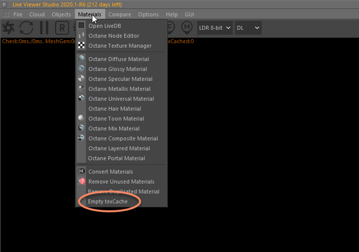

FH wrote:Ok will do. Can you show me where that command is ?aoktar wrote:give a try and also use 2020.1-R6

The command I pointed that should solve this issue. Other than this delete prefs folder of c4d and try again.FH wrote:[2020-06-01 16:02:21][1] generate material:M_1asd0f1a6s0d16w016[2020-06-01 16:02:22][1] OCT:the following error occurred while reading a binary blob: failed load data array
