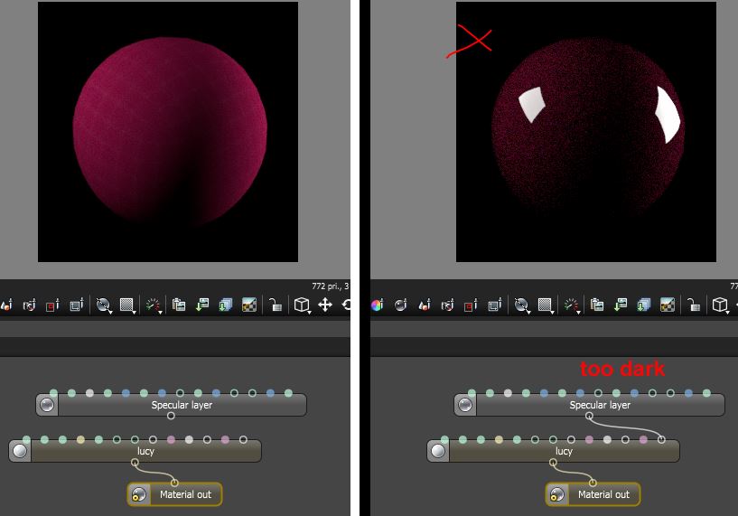

1) Layered material: viewtopic.php?p=364046#p364046
Both materials render the same now, but have become quite dark. I don't think this is right

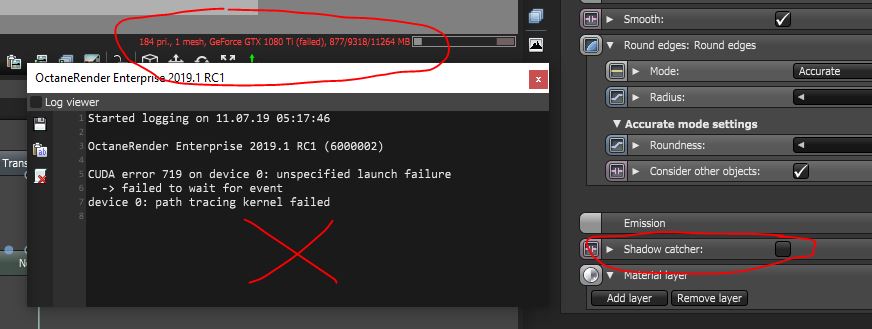

7) CUDA crash toggling shadow catcher pin on and off: viewtopic.php?p=364534#p364534
Still a problem in RC1
Code: Select all
Started logging on 11.07.19 05:17:46
OctaneRender Enterprise 2019.1 RC1 (6000002)
CUDA error 719 on device 0: unspecified launch failure
  -> failed to wait for event
device 0: path tracing kernel failed

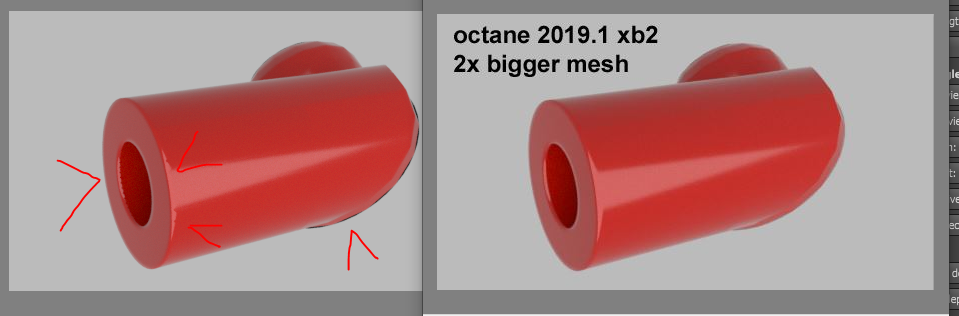

8) Rounded edge artifacts: viewtopic.php?p=364878#p364878
While the really obvious artifacts were fixed on the small mesh, the big mesh has worse rounded edges than XB2 now

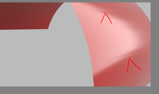

9) Rounded edges: viewtopic.php?p=364887#p364887
Once again, the obvious artifacts were fixed, but I now see some "lines" on what should be a smooth surface. Toggle rounded edges off fixes it.
