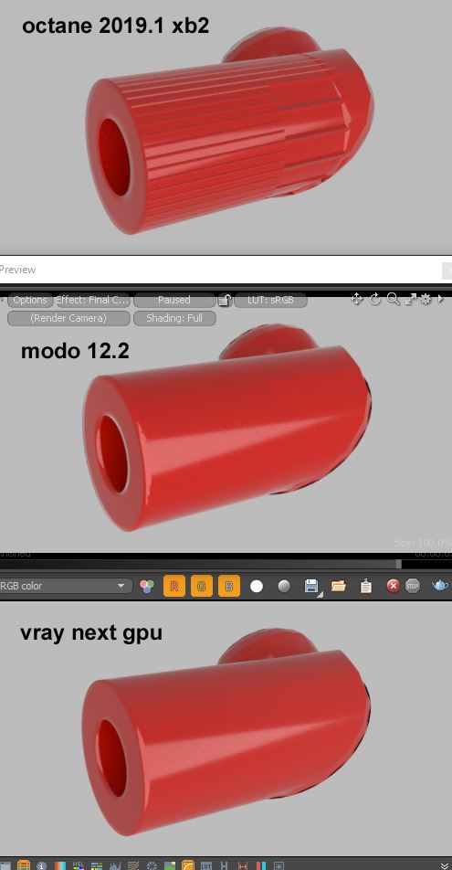

Here is one more example of rounded edges compared to other renderers
This is some isolated geometry imported from an ldraw lego cad model . Yes, I agree the geometry is quite bad, but I'm pointing out that modo and vray handle rounded edges much better.
All renders are generating rounded edges as a shading effect. Vray is also doing it on GPU.

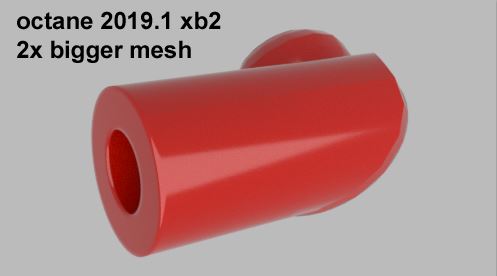

UPDATE: It seems to be an issue related to the size of meshes. If I make the mesh 200% bigger, the artifacts go away

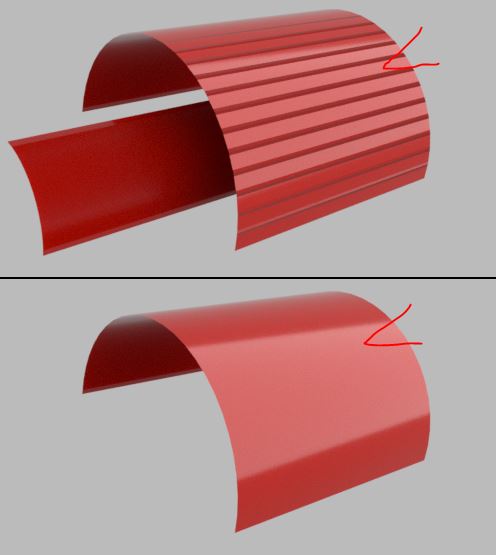

I've tried to simplify the previous scene further. I have separated it down to 2 pieces. If I hide one of the pieces, the artifacts go away. So this seems to be some kind of bug in rounded edges.
1. Load the orbx and click the render target to start rendering. You'll see artifacts on the front piece
2. Unplug "mesh2 mesh" from the object layer. The artifacts go away
NOTE: You can also disable "consider other objects" in the red material round edge, BUT the original scene was all 1 mesh, so that wouldnt help

I discovered making the mesh double the size, removes the artifacts. I added the info + orbx to the original post (2 posts up)
So it seems to be a bug related to mesh size.
In the original imported lego scene, I have to make the meshes about 500% larger to avoid any artifacts.

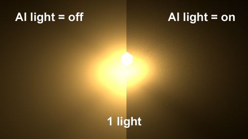

I have a scene where AI light is making lights darker (even when there is 1 light)
Here is a stripped down scene with a single emitter mesh. When AI light is enabled, the light becomes darker.
ai_light_change_brightness.orbx
(84.79 KiB) Downloaded 269 times

funk wrote:I discovered making the mesh double the size, removes the artifacts. I added the info + orbx to the original post (2 posts up)
Thanks, fixed for next release.
