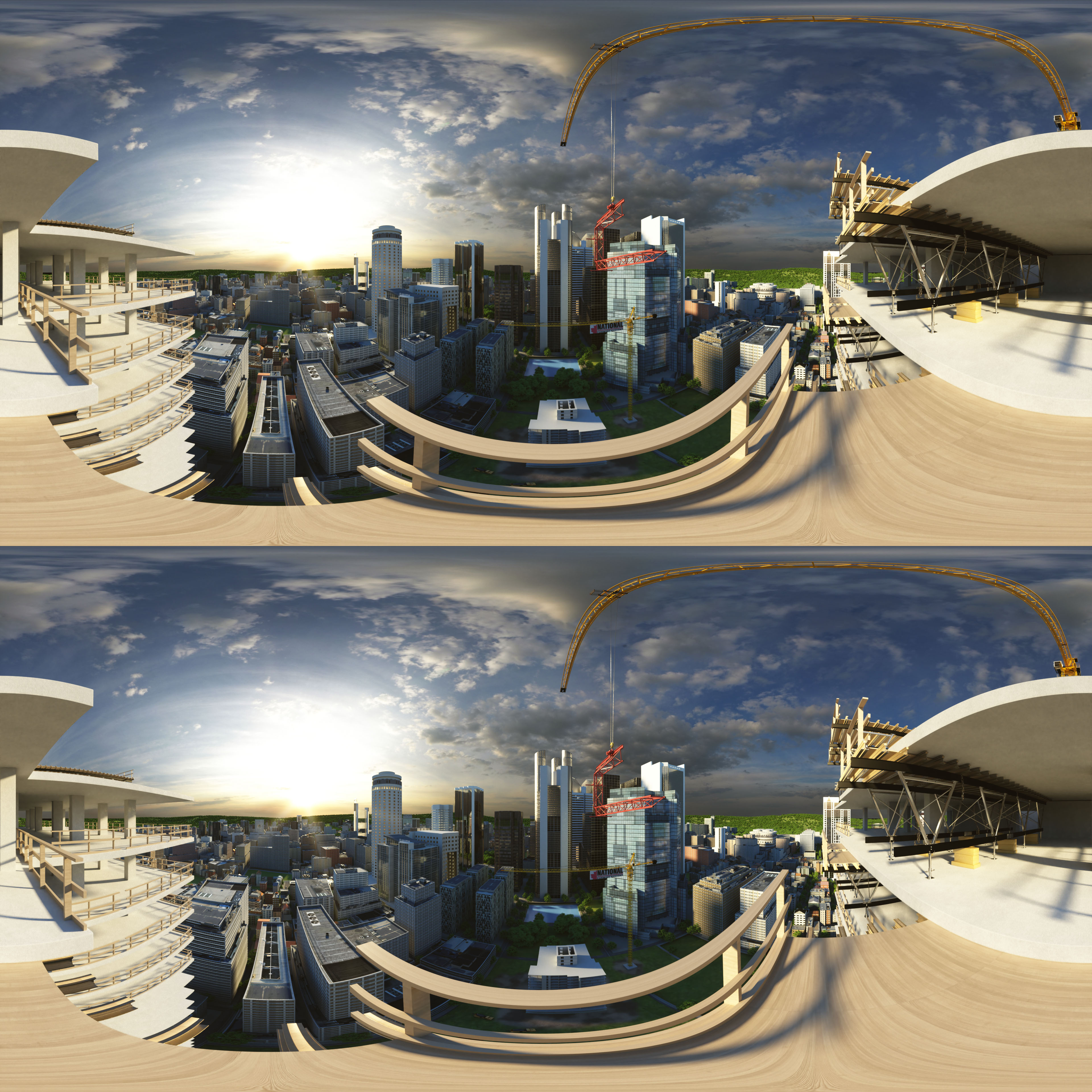

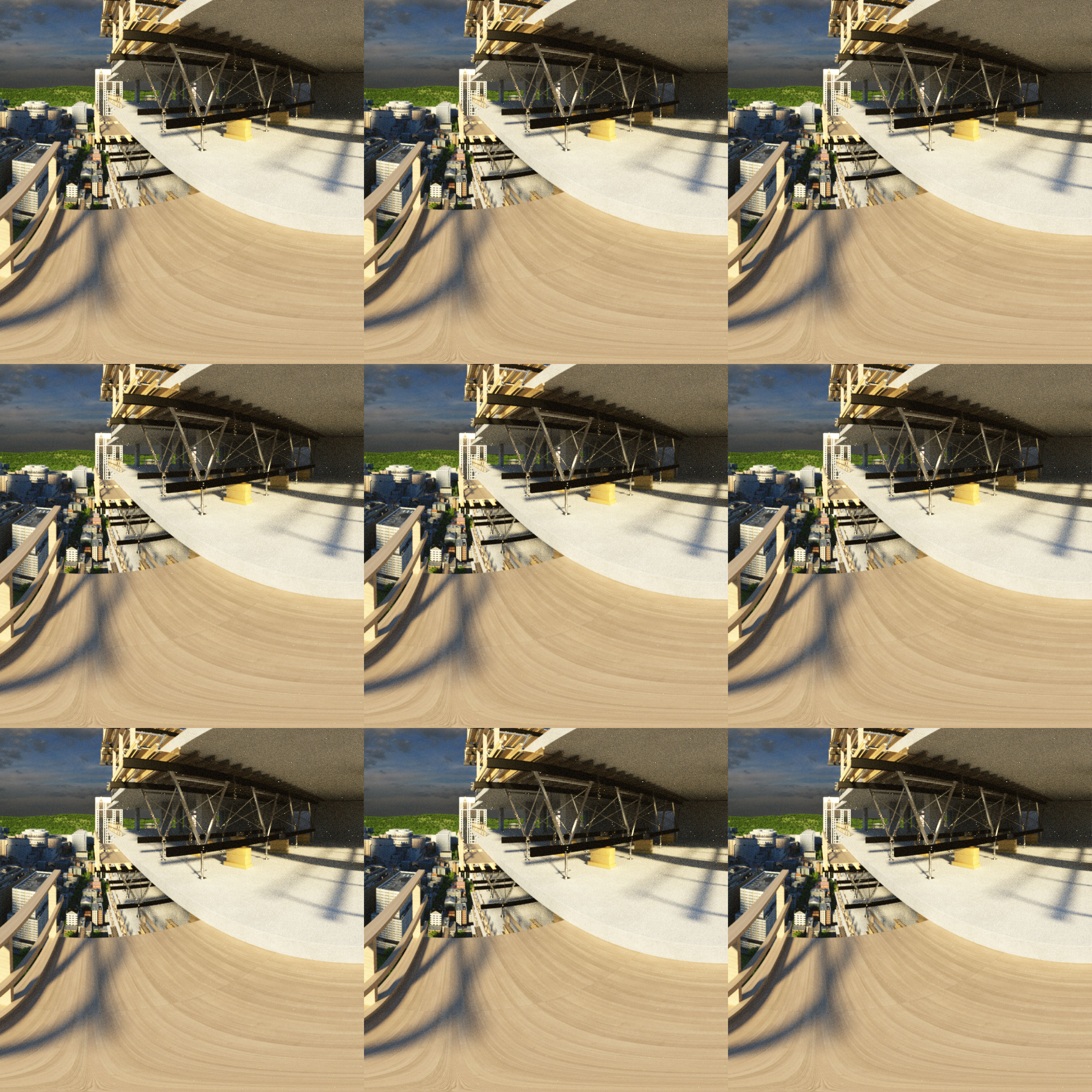

I was very excited to test the upsampler on one of the bigger projects, a 4K VR animation...I did these two tests without and with the upsampler on 2x2 (see below)
seems like stereo distribution confused the crap out of it lol...am I doing something wrong or does this need to be fixed still by developers?
thanks,
Al
Upsampler turned off (result as expected)
Upsampler turned on (def not as expected)

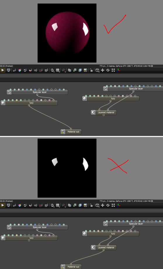

						I've run into a bug with the layered material node.
As far as I can tell, the 2 materials I've set up below, should look identical, but the "layered material" version is incorrect and renders the base material black.
1. Load the attached orbx and start rendering
2. Double click the "TEST_MATERIAL" nodegraph node
3. Plug the "layered material" into the material out

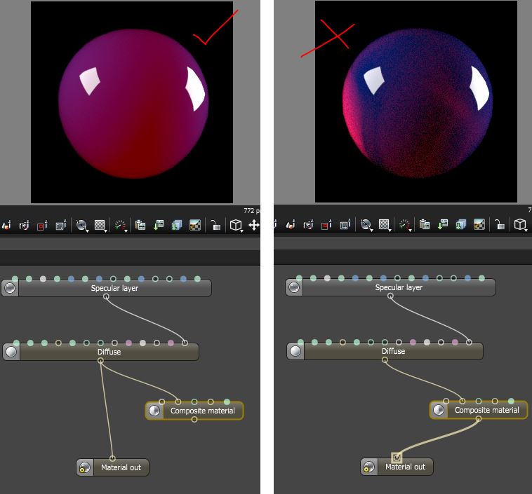

This is a similar bug to the one I posted before. This time using a composite layer renders incorrectly.
I think all of this is related to the diffuse material's transmission when combined with a specular layer.
2. Double click the "TEST_MATERIAL2" nodegraph node
3. Plug the "composite material" into the material out

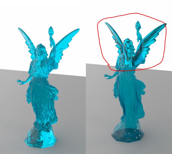

I'm getting strange results with the universal thin wall option, when the environment is visible behind it.
I have a grey plane under the statue. The white background is an environment image.
