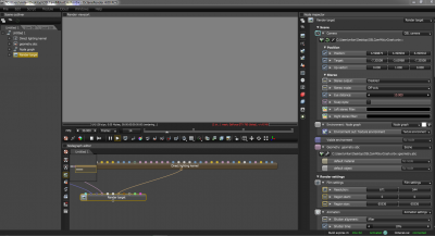

I was trying to get motion blur to work with OSL camera shader when I noticed the crash.
I just did some more testing and It looks like it's hardware specific. It crashes on two of my computers with different GTX780s in them (Windows 7 - 388.71 on both). Updating the driver didn't help. I can reproduce the crash on V4-RC5 as well as 3.08.3 and earlier 3.08 versions.
This is probably related to this discussion. I was trying to reproduce the exact same issue.
You can see the issues with motion blur and also network rendering in Joel's twitch live stream, I managed to find the relevant parts:
OSL Cam + Motion blur
https://www.twitch.tv/videos/314426564?t=02h50m30s
Network Render
https://www.twitch.tv/videos/314426564?t=03h54m45s
Here is the log from yesterday:
octane 4.00 RC5 180925 115850.log
(214 Bytes) Downloaded 283 times
And here's the log from the other machine:
octane 4.00 RC5 180926 063416.log
(214 Bytes) Downloaded 279 times
GTX780 render fail:
Thanks for looking into this!

Thank you for the report. Yes, there is a bug in the OSL camera that causes it to overwrite the correct time sample with an unitialized one. It seems it's usually 0, i.e. doesn't crash but renders no motion blur, but if it's out of the range of [0, 1] it will most likely cause the kernel to fail.
It will be fixed in the next release.
