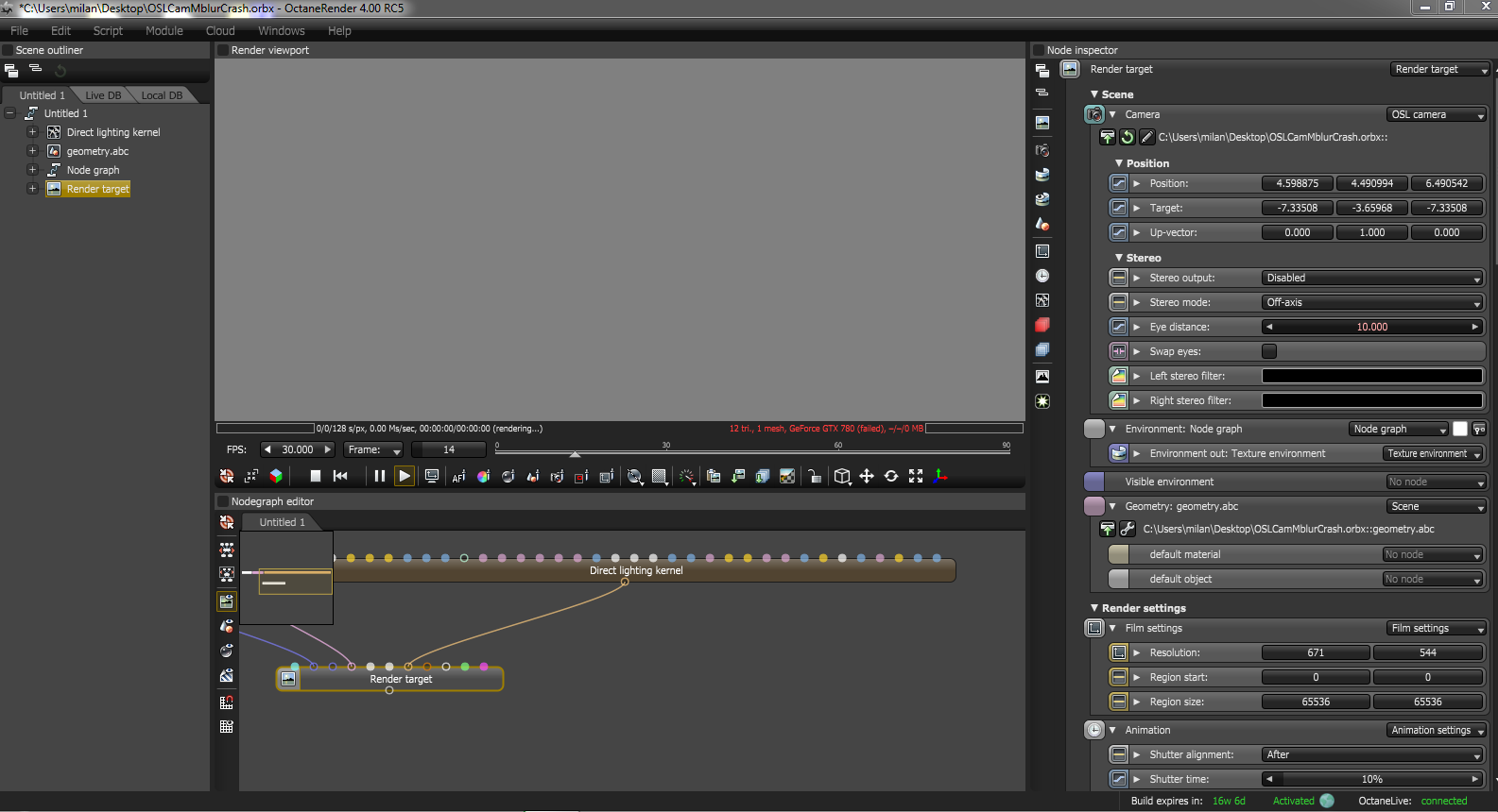

I just noticed that there is a crash with animated objects when OSL camera shaders are used and motion blur is enabled.
OSLCamMblurCrash.orbx
Hmm, the scene renders fine and doesn't crash. What do we have to do to make it crash?

I was trying to get motion blur to work with OSL camera shader when I noticed the crash.
I just did some more testing and It looks like it's hardware specific. It crashes on two of my computers with different GTX780s in them (Windows 7 - 388.71 on both). Updating the driver didn't help. I can reproduce the crash on V4-RC5 as well as 3.08.3 and earlier 3.08 versions.
This is probably related to this discussion. I was trying to reproduce the exact same issue.

GTX780 render fail:
Thanks for looking into this!

Thank you for the report. Yes, there is a bug in the OSL camera that causes it to overwrite the correct time sample with an unitialized one. It seems it's usually 0, i.e. doesn't crash but renders no motion blur, but if it's out of the range of [0, 1] it will most likely cause the kernel to fail.
It will be fixed in the next release.
