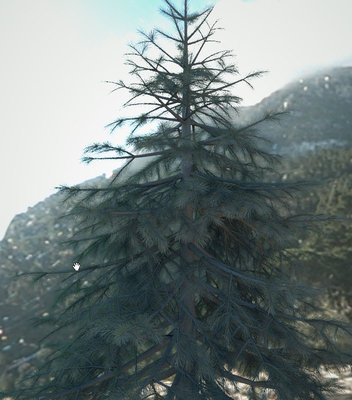

Here is one quick and dirty test with conifer tree. For some reason i ended up with just one material for this tree in octane( there should be 7) but i decided to play around with diffuse transmision channel. Here are results. Outstanding stuff for adding variety to leaves or needles in this case:) I'll do few more tests and post results.
Wow yeah it look really cool !
The subtles shades and variations in the color make it very realistic looking ;)
And you say its only 1 material for all the tree ? :shock:

Just one dark gray material. Other colors are from hdri light and fake sss.

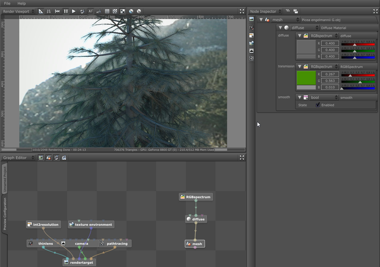

Dude you have to post the graph editor for this. (Please) You certainly have displayed an uncany command of this program. KUDOS

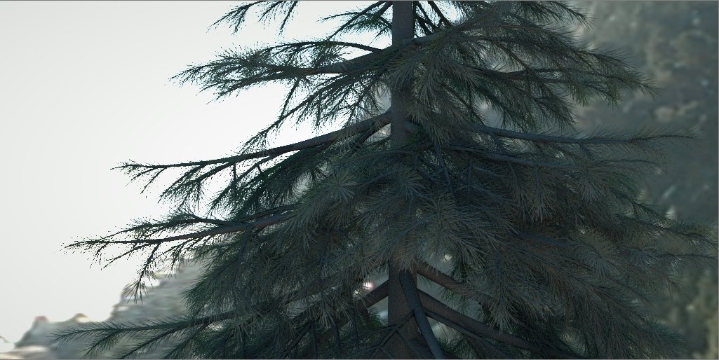

Quick test using n1k settings

Hi Tugpsx. It's basically same material/light setup as in my previous tests. I'm glad you like the results:) I didn't save original SS before I cropped it so i ran new test with similar settings.
Cheers,
n1k
EDIT
P.S. I forgot to mention that is very important to have geometry with no thickness in oreder for fake sss to work properly.
