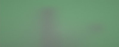

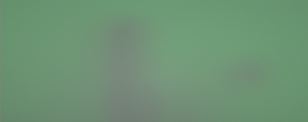

Here is result from simple test . I created plane and put some object in front of it. The plane has diffuse material set up as radiance suggested. Translucency effect is very subtle and I thik it would be a bit more pronounced if there was some direct source of light(sun for example:) )
This setup is ok for cloth and paper like materials, but what about leafs which need to be glossy? Can similar thing be done with a glossy material as well?

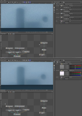

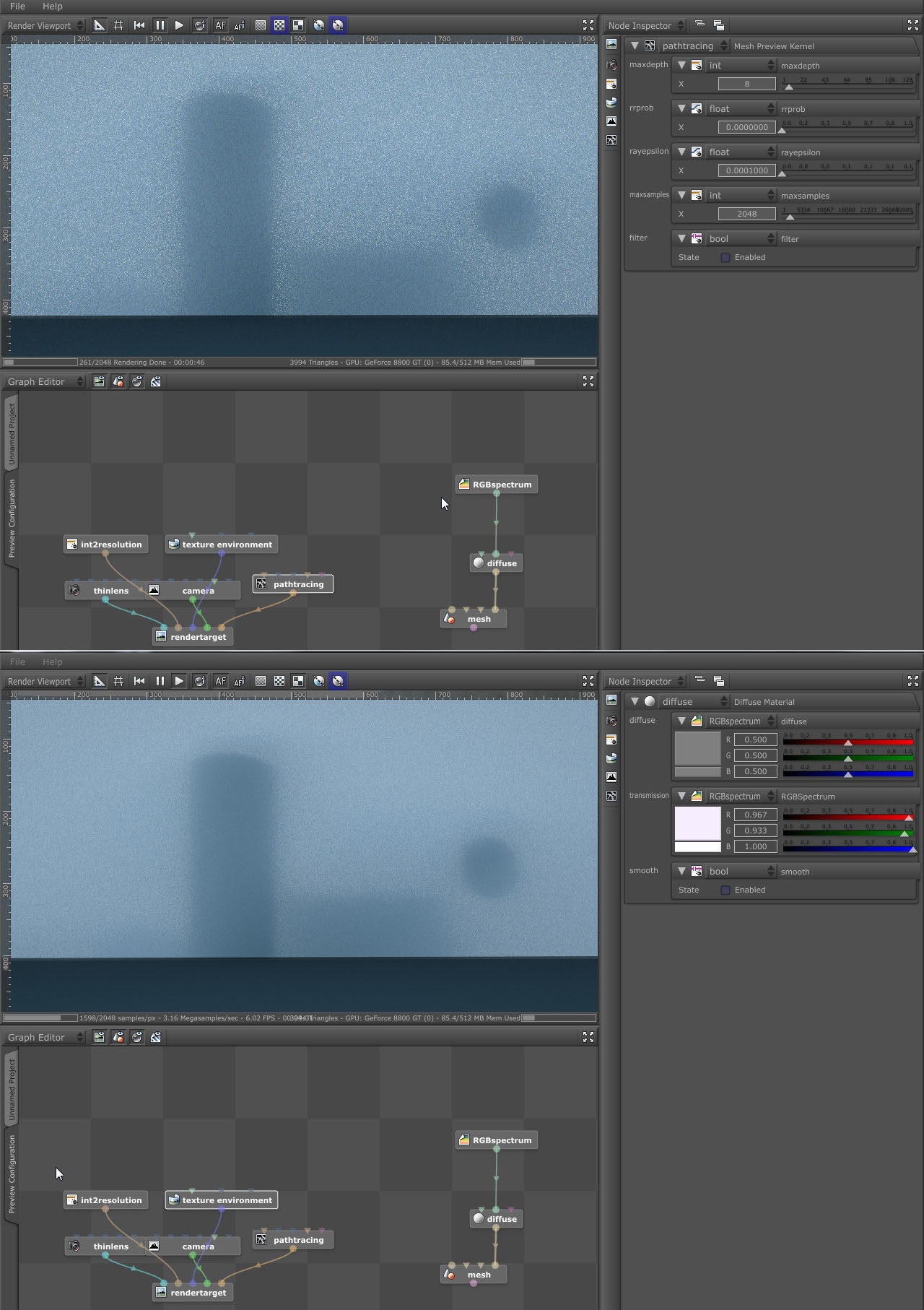

Tugpsx
Posts: 1180
Location: Chicago, IL
@n1k can you post your graph setup. Just trying to clarify how you got the pusdo SSS effect
n1k
Posts: 401
Joined: Mon Jan 11, 2010 7:55 pm
Sure. This time i used hdri with sunny sky(in first test was octane_studio1.hdr) and rotated it so that sun is in front of the plane. Pathtracing needs to be enabled.
Hope this helps.
