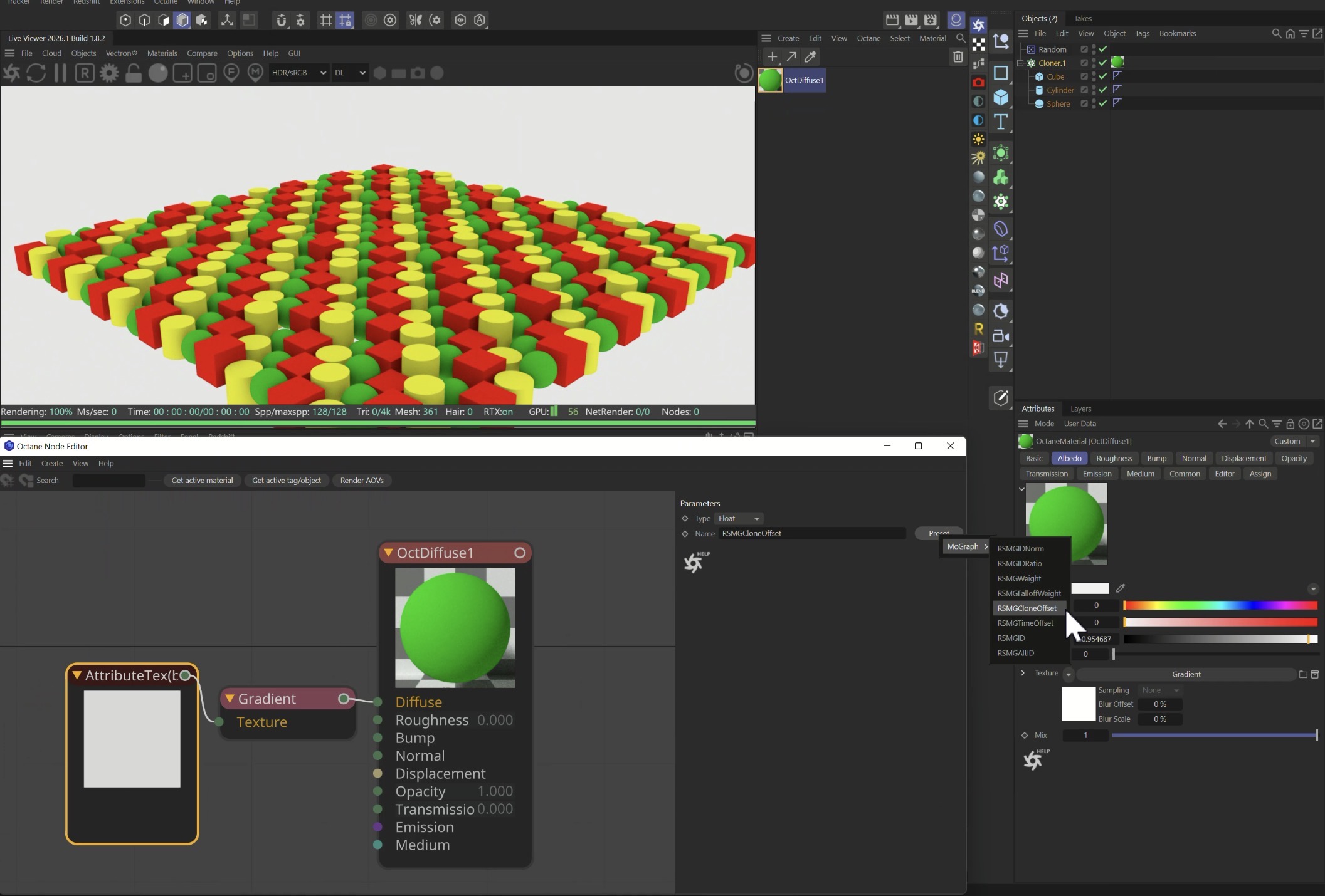

special.agent1990 wrote: Sun Dec 07, 2025 12:03 pm Can you confirm whether the following features are actually working? They don’t appear to be functioning on my end:
• Support for C4D’s User Data Tag (via AttributeTex node)
• Mograph data support (via AttributeTex node)
Here is an example of using RSMGCloneOffset value in Attribute texture node:
RSMGCloneOffsetAttributeExample.zip
(191.47 KiB) Downloaded 72 times
ciao,
Beppe

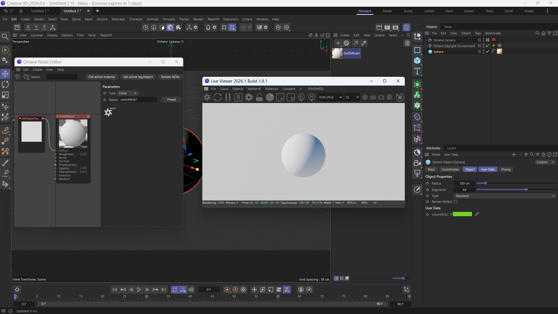

special.agent1990
Posts: 17
Joined: Sat Apr 02, 2022 7:26 am
bepeg4d wrote: Tue Dec 09, 2025 10:02 am
ciao,
Beppe
Thanks.
Doesn't seem to be working with older scenes.
Also attached is a screen shot using Cinema 4d User Data, a color attribute named colorattrib1, -having a green color- is assigned to the sphere. The same attribute is then read using an AttributeTex node. If everything were working correctly, the sphere should appear green, but it doesn’t seem to be reading the attribute.
Let me know what you think.
