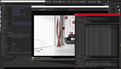

First try on older scenes and get a crash.
Regards,
Regards,

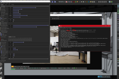

Second scene I get crash out of the gate.
Am I missing something?
Regards,
Regards,

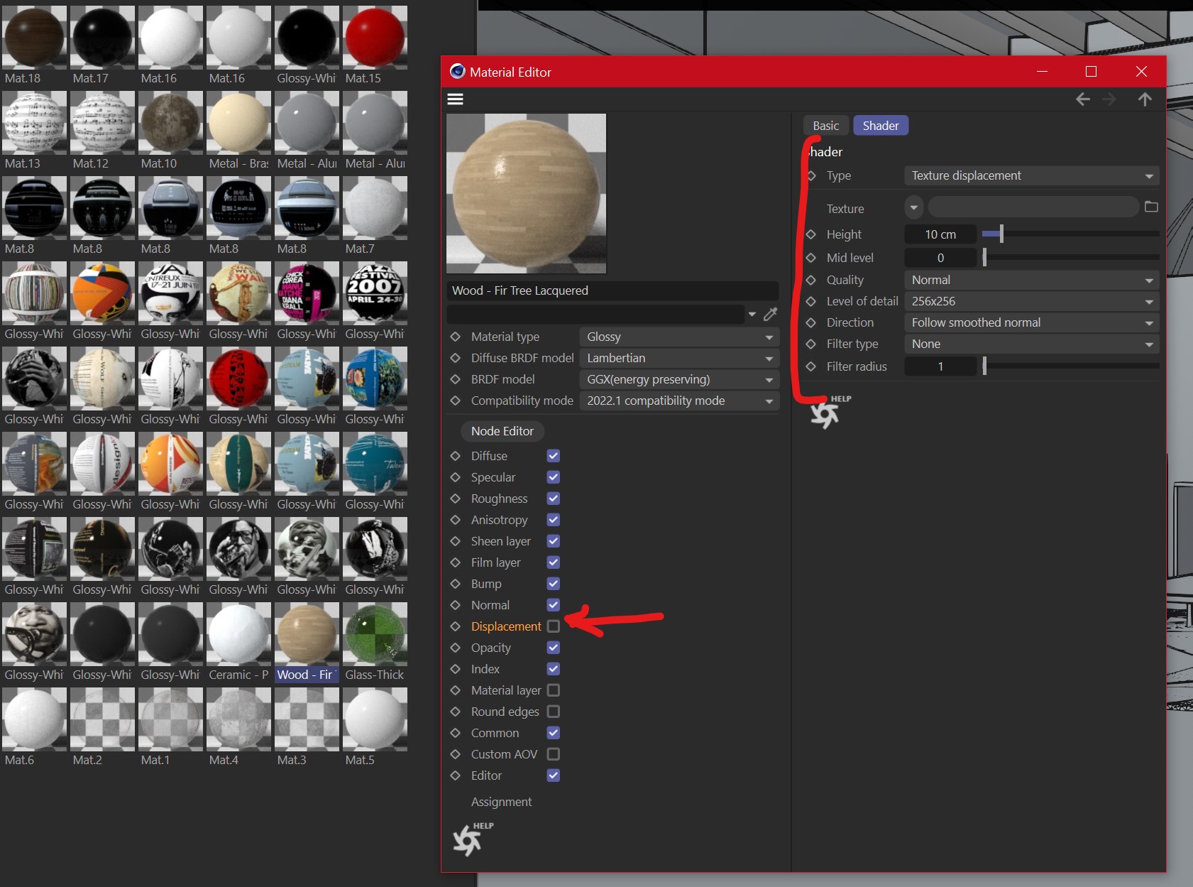

I see now, all shaders automatically got a deactivated displacement node with empty texture node?
By the way, older ORBX files are rendering just fine in Stand Alone.

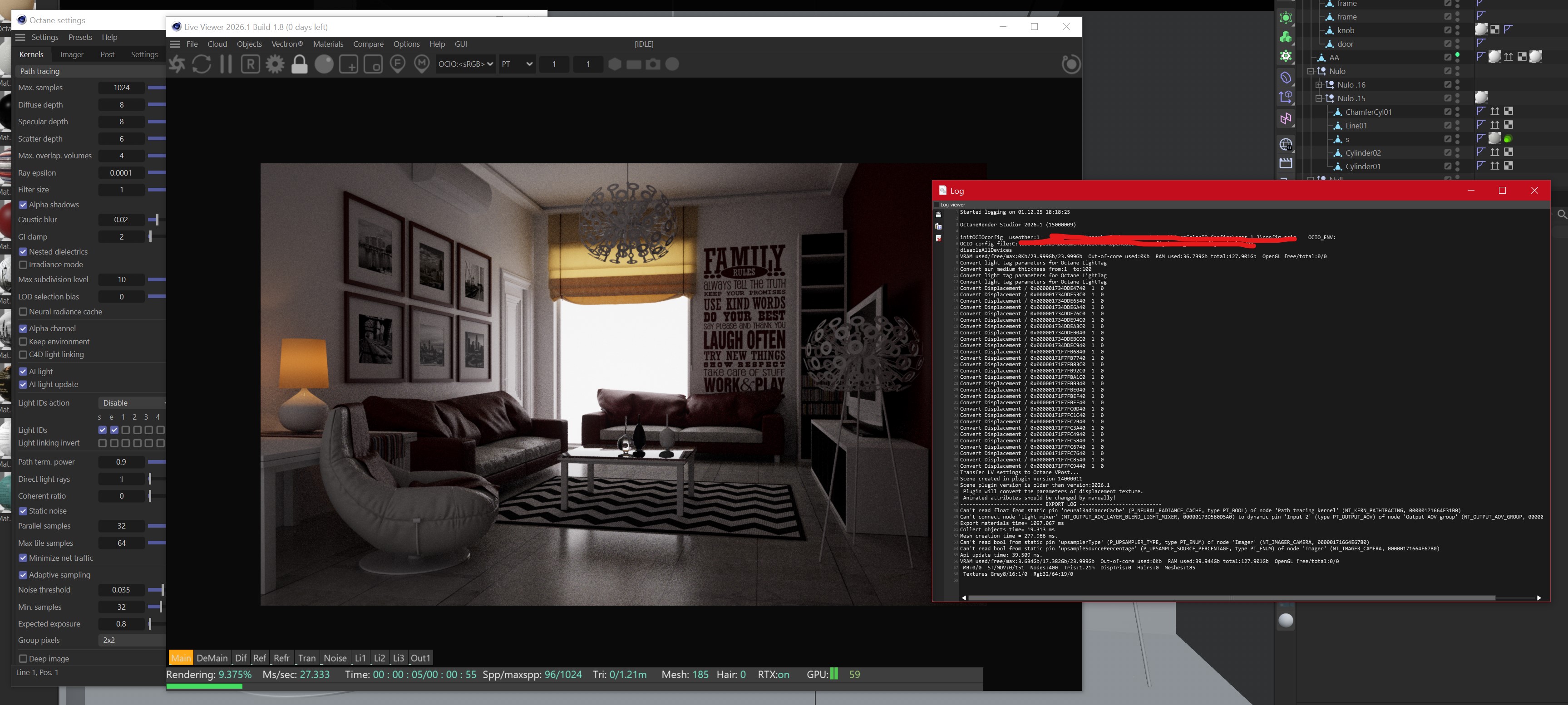

Here is another older scene with issues.
- Attachments
- octane 2026.1 251202 003551.txt
- (11.18 KiB) Downloaded 80 times

They are logging errors, not crashes. Those errors should have no efffect on your scene unless you are using the Upsampler or Radiance cache. We will shortly be releasing a hotfix for these logging errors.Kalua wrote: Tue Dec 02, 2025 6:11 am Second scene I get crash out of the gate.
Regards,

Could you share a scene with us that has this issue?Kalua wrote: Tue Dec 02, 2025 6:16 am I see now, all shaders automatically got a deactivated displacement node with empty texture node?
