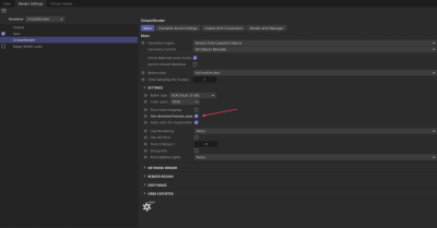

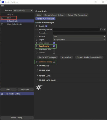

Confirmed, the issue is back, please disable C4D Save option, save your results via Render Settings/OctaneRender/Render AOV Manager tab, and enable the "Denoised beauty" option, everything is working as expected: ciao,Idonee wrote: Mon Dec 01, 2025 9:46 am Hey. Seems "use denoised beauty pass" іs it not working, or is it just for me?
Beppe
