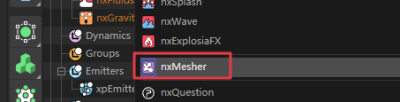

Today I tried the new version of X-Particles and found that I can preview when rendering nxMesher, but it crashes when sending a full render. Turning off nxMesher also causes Octane to crash. I don't know if this issue is related to Octane or INSYDIUM, so I will report it to both places.
Cheers.

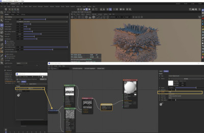

About new Texture Displacement, you need to have the Projection node to Mesh UV, and the Quality to High:
If Quality is set to Normal, you go back to old Texture Displacement.

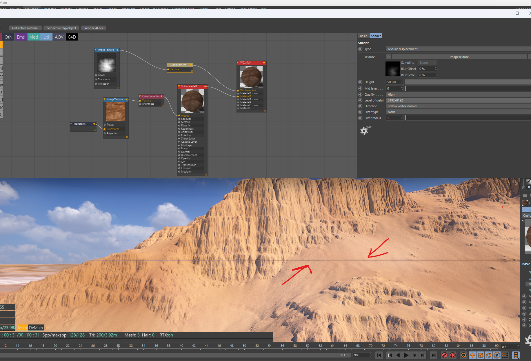

Maybe there’s another issue with the new texture displacement. As soon as I activate it in a very basic scene, I start seeing a black line running through the rendered image (see attachment). Switching the quality to “Normal” fixes the issue, since it switches back to the old texture displacement. I’m not sure whether this is something on my end or a more general problem.

Please export your scene in .orbx then share it with core devs in this discussion:
viewtopic.php?t=85315
Thanks.
