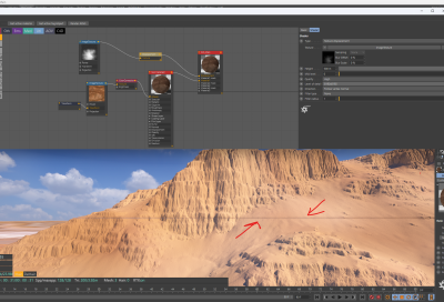

Maybe there’s another issue with the new texture displacement. As soon as I activate it in a very basic scene, I start seeing a black line running through the rendered image (see attachment). Switching the quality to “Normal” fixes the issue, since it switches back to the old texture displacement. I’m not sure whether this is something on my end or a more general problem.

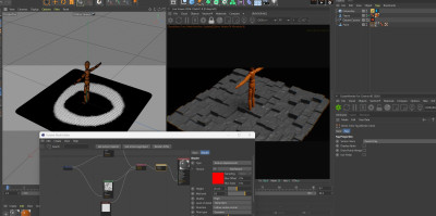

Hi guys, can you help me, vertex displacement doesn`t work with mix texture. Maybe I'm doing something wrong when I try to throw a vertex map into an amount of mix node.
