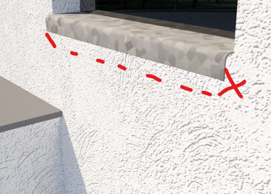

While using Photon Tracing shadows from thin objects are gone.

SSmolak wrote:While using Photon Tracing shadows from thin objects are gone.
Try to decrease "Ray Epsilon" from default number. :)
