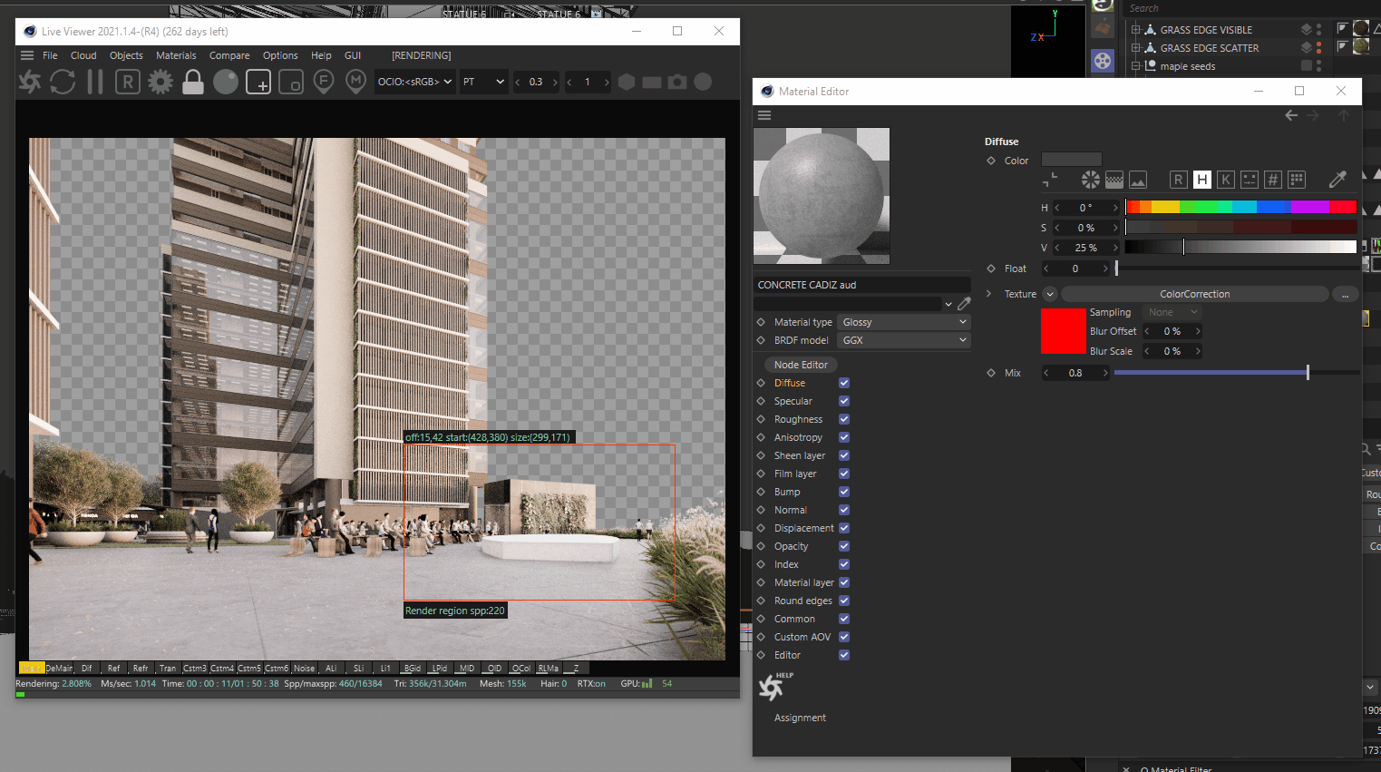

This is the kind of behavior it has been happening lately (with or without use of "Takes"). Not updating camera and shaders mainly:Kalua wrote:I have noticed Camera movement has started to not update in LV window in some cases: when I am using "Takes", and I copy the set camera and keep using the Take set camera, I need to change the set camera and back to make it responsive in the Liveview window.SSmolak wrote:After changing LV camera behavior Octane stopped updating materials - if new polygons are included or excluded from material tag or new material is added to objects. There is need LV restart to update them.
